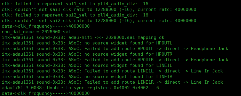

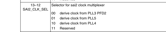

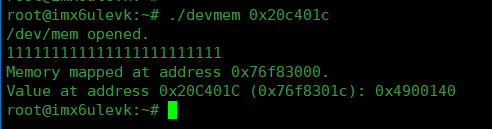

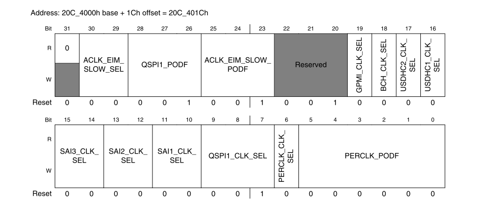

Hello, I am using imx6ul, the kernel is linux4.14.78,
I used the i2s external audio chip, but the audio clock is wrong and I can't generate the clock I want. I checked the imx6ul chip manual and found
The register configuration is 10 for PLL4 as the parent clock. But I read it out is 00.
My device tree configures the PLL4 bit parent clock
I should do it exclusively?

jieh朱
thank you for your reply
After I enable the frequency, I start the error.

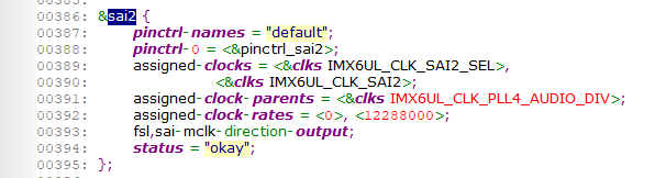

&sai2 {
    pinctrl-names = "default";
    pinctrl-0 = <&pinctrl_sai2>;
    assigned-clocks = <&clks IMX6UL_CLK_SAI2_SEL>,
              <&clks IMX6UL_CLK_SAI2>;
    assigned-clock-parents = <&clks IMX6UL_CLK_PLL4_AUDIO_DIV>;
    assigned-clock-rates = <0>, <12288000>;
    fsl,sai-mclk-direction-output;
    status = "okay";

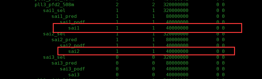

jieh朱
   I look at the clock tree
according to dts
sai2 Parent clock is IMX6UL_CLK_PLL4_AUDIO_DIV
