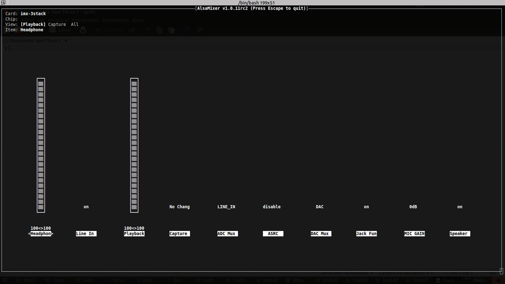

We made some tests using the IMX53 QSB  with original kernel from NXP:
Kernel: 2.6.35.3-1129-g691c08a
root@freescale ~$ gst-launch-0.10 --version
gst-launch-0.10 version 0.10.28
GStreamer 0.10.28
Link:
https://www.nxp.com/webapp/Download?colCode=L2.6.35_MX53_ER_1109_IMAGE_&appType=license&location=nul...
PC - connected to speaker and microfone (headset)
IMX53 - Only speaker (headphone)
Both are connected to the same LAN, We use the same script that we posted.
When the alsamixer is configured to Line IN,  the echo appears.

caiopereira
Today we tested the sgtl5000 using IMX.53 Quick Start Board with Yocto 2.0 (kernel 4.1.13-fslc+ge55a6a9) and we got the same result.
The eco is lower than our test with Colibri IMX.6.

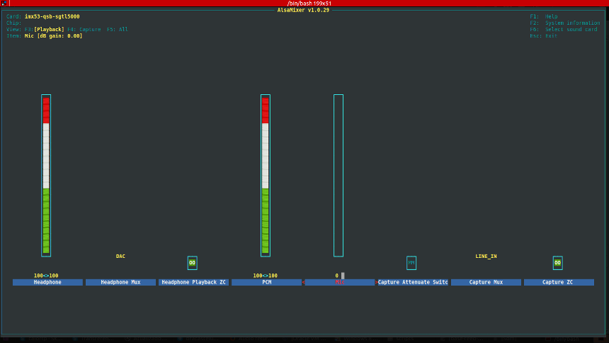

Most likely, you get some loopback configuration on your Colibri board side. First, try to change the 'Headphone' parameter from LINE_IN to something else when you're changing the 'Capture' parameter to LINE_IN in Alsamixer.
Artur
9,227 Views
alledpaiva
Hey Artur!! First of all, Thanks for the hint!
We already did this changes! 'Headphone mux' is fixed to DAC because the audio we only have HP_OUT to listen the audio (Colibri board side).
And the result found was:
-> Using MIC we have no ECHO.
-> Using LINE_IN we have a loud ECHO ! (I think that it can be some type of loopback (audio routing), because we have tested on our hardware keeping the LINE_IN opened, and the audio was still returning! ) wich makes us think that STL5000 is returning!
But we read the i2c register (kernel Debug) and we think (by reading SGTL5000 Datasheet) that it is correct.
9,227 Views

alledpaiva
Artur,
To get these information, I ran gstreamer (on PC and Colibri Board) and with this alsamixer configuration below (Colibri side):
i've got this data:

OBS.: If I turn down the level of Headpone or PCM the level of returning is lower too.
