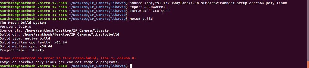

santhosh2
Hi igorpadyko,
Thanks for the link, But it doesn't cross compile for I.MX8MMIni (See the attachment)
Let me know if i had made any procedural mistake
