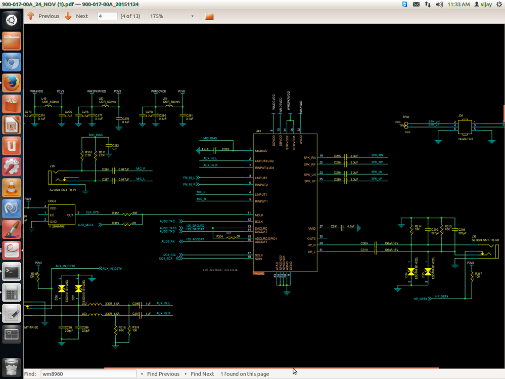

Hi ,
          I want small info.I took sabresd reference, Audio COdec working fine( I can able to record & Listen audio),As per imx-wm8960(Machine drivers) routed Audio Codec(WM8960) to MIC(input1 ADC to store audio in Process) & Head_phone(Processor's DAC to output channel).
But As per my requirements i need to play Auxillory audio stream which connected to 2nd input channel & FM in 3rd input channel(Like below pic).
So how i can route it in imx-wm8960.c file like below.
static const struct snd_soc_dapm_route imx6_audio_map[] = {
    { "Headphone Jack",         NULL,           "HP_L"      },
    { "Headphone Jack",         NULL,           "HP_R"      },
    { "Speaker_L",              NULL,           "SPK_LP"    },
    { "Speaker_L",              NULL,           "SPK_LN"    },
    { "Speaker_R",              NULL,           "SPK_RP"    },
    { "Speaker_R",              NULL,           "SPK_RN"    },
    { "LINPUT1",                NULL,           "MICB"      },
    { "MICB",                   NULL,           "Mic Jack"  },
//    { "LINPUT3",                "LINPUT3 Switch",       "HP_L"   },
//    { "RINPUT3",                "RINPUT3 Switch",       "HP_R"   },
I am waiting for your reply. Thank you.
