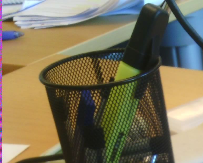

I'm using the Android KitKat imx6 BSP with provided libcamera HAL with the addition to rotate the encoded JPEG image.
This is done in "YuvToJpegEncoder.cpp" by setting, "sEncOpenParamSimp.nRotAngle=rotation" for vpu_wrapper.
This works fine for all image sizes except 2592x1944, where I get artifacts on the image border, as can been in image below.
This problem only occurs when the image is rotated 180 or 270 degrees, 0 and 90 looks fine.
Have anyone else seen this problem or have any idea on what could be wrong?
Update: This can be reproduced with mxc-vpu-test using a YUV image 2592x1944.
mxc-vpu-test -E "-i /data/local/camera_tst.data -f 7 -r $rotate -w 2592 -h 1944 -o /data/local/image.jpeg"
