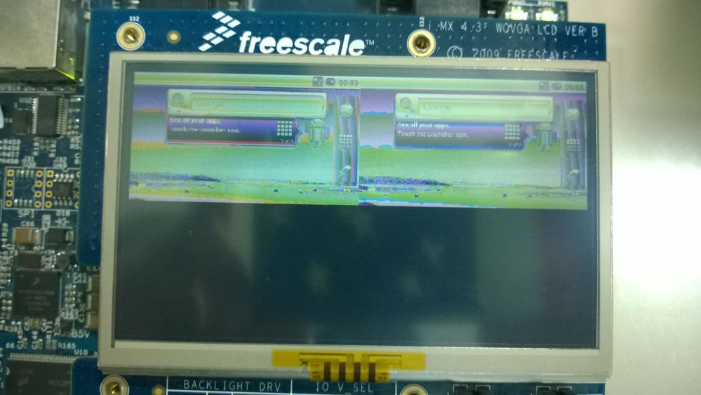

Hi everyone,
I am trying to port Android onto iMX23evk. I tried converting the linux BSP provided along with the board to Android Kernel by adding the essential components to it and I have compiled Android Froyo in emulator mode and I have performed chroot to android file system on the board.  I have ended with the following display. I think this is due to mismatch in the screen resolution between emulator and the actual screen on board. As I am new to this, I am not able to fix it. Please help me to correct it.

Hi Venkatesh
for LCD testing and verification one can try to reuse i.MX28 OBDS lcd test
IMX_OBDS : On-Board Diagnostic Suit for the i.MX28.
Also useful some i.MX23 porting hints on below link
Porting Linux to a new board — Christian's Blog
igor

kpoojari7
Hi igorpadykov,
Thank you very much for your reply.
Actually I have no problem with the LCD as the Linux boot image is displayed clearly.
After I perform chroot to android file system I am getting this problem (as seen in the above attached image).
I wanted to know how to set the screen parameters from the android end.
