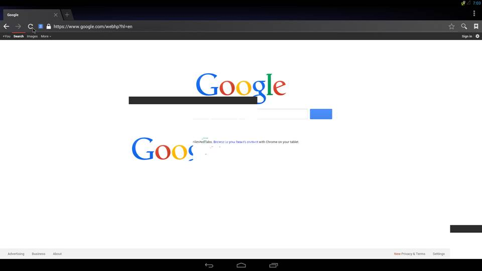

I would refresh Browser some times on the Android platform. The Google search web site sometimes menu break occur.
Test environment : Sabre-SD board
BSP version : android_jb4.2.2_1.1.0
How to improve this situation ? Thanks!

To fixed for this issue is needs to update the GPU library.
Please see attached
Android jb4.2.2 GPU upgade with the latest 4.6.9p13 (used in jb4.3)

I have the exact same problem. Same BSP version android_jb4.2.2_1.1.0. Connected to HDMI I can see the problem using hight or low resolutions. In my case is possible to reproduce by fast scrolling up or down a page with some images and a lot of text.
Someone found a workaround?

Is your output to HDMI or LVDS?, what is the resolution of the screen?, i haven't been able to replicate this issue...
2,999 Views
weikeng-jimmy
LVDS resolution : 1024x768
You can replicate when touch refresh button quickly .
