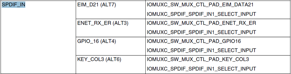

weidong_sun
Hi Daniel,
      If  you want to use SPDIF input feature, you should multiplex SPDIF_IN signal via one of the following CPU PADs on you board(hardware) :
Then add multiplexing codes to BSP file or corresponding header file, multiplexing PADs are defined in ~/myandroid/kernel_imx/arch/arm/plat-mxc/include/mach/iomux_mx6q.h
Please try it on!
Weidong
