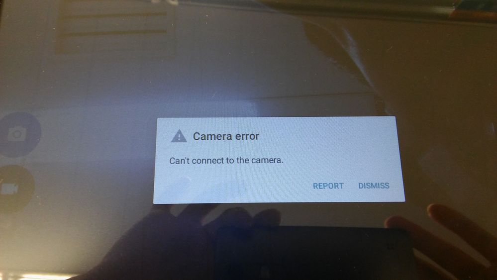

Hi freescale
About camera issue.
I have tested the Android 6.0.1 Demo image on an i.MX6Q SABRE-SD board.
Do you have any advice about the issue?

Hi Guanqiong Xie
I check the issue.
Our demo board show "camera ov5642 is not found" and "camera ov5640_mipi is found".
So I think so it's front end camera fail.
I try to disable front end camera. The issue is fixed.

how did you get this error message? just booting up the board from demo image?

Hi Guanqiong Xie
I check the issue.
