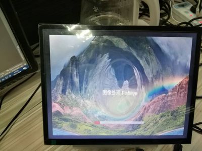

While running the Antutu benchmark test on i.mx8 Android 9.0, Antutu stucked at 图像处理FishEye window.
Could you let me know how to sloved it?
The following is the log,it stuck at 9:40.Please see the attachment for the detailed log

CordialMai

Please try the new version of Android, this an issue that is not fixed on android 9 but it has no problems running on android 11.

I am sorry for the above reply is confusing, please ignore it.
Thank  you very much for your reply.
But we have spent a lot of time on android9.0 to develop custom function. Try the new version of Android11 will cost a lot of time.
Do you have any other idea to slove it ?
I catch a serial log,it contains the following message:
[ 3086.660484] **************************
[ 3086.664439] ***   GPU STATE DUMP   ***
[ 3086.668258] **************************
[ 3086.672076]   axi      = 0x00000070
[ 3086.675842]   idle     = 0x7FFFBF06
[ 3086.679480]     FE not idle
[ 3086.682274]     SH not idle
[ 3086.685270]     PA not idle
[ 3086.688079]     SE not idle
[ 3086.690872]     RA not idle
[ 3086.693735]     TX not idle
[ 3086.696625]     MC not idle
[ 3086.699488]   DMA appears to be stuck at this address:
[ 3086.704640]     0x1EC9FFC8
I searched the community and found a similar issue:
https://community.nxp.com/t5/i-MX-Processors/GPU-STATE-DUMP-DMA-appears-to-be-stuck-at-this-address/...
The detail log please see attachment 'antutu_serial_log.log' ,it stucked on 图像处理FishEye window about 19:24.
It seem as if it can ben sloved by upgrade GPU patch on IMX6dual JB4.3 release.
So I hope I can sloved it by using the same method on i.mx8 Android 9.0.
Best regard.

CordialMai
 add AnTuTu stuck ScreenShot
