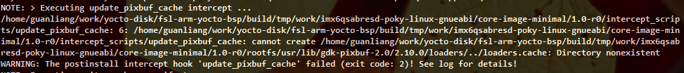

guanliangding
Hi Daiane:
     Thanks!
     I used follow command to building image.
$ source setup-environment build
$ bitbake core-image-minimal
     But have some warning of do rootfs, it is a bug? And how can i to solve this issue?
WARNING: The postinstall intercept hook 'update_pixbuf_cache' failed (exit code: 2)! See log for details!
WARNING: log_check: There is a warn message in the logfile
WARNING: log_check: Matched keyword: [WARNING:]
WARNING: log_check: WARNING: The postinstall intercept hook 'update_pixbuf_cache' failed (exit code: 2)! See log for details!
