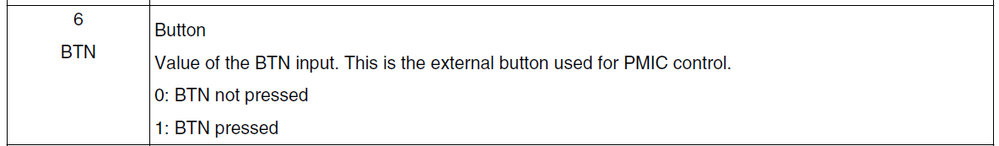

hello,Community
Sorry, the information is missing
The target device is i.MX7d.
Can the status of the button connected to the ONOFF pin be read with a register?
best regards
Goto

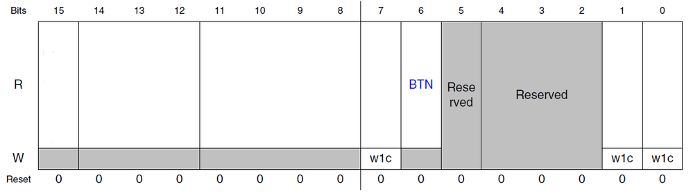

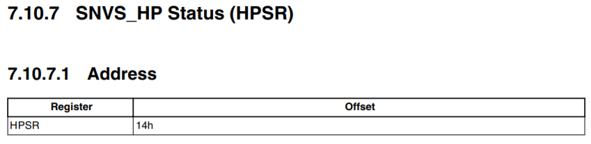

gusarambula
Hello Goto,
My apologies for the delay.
If you want to check that the ONOFF button is pressed or not you can read BTN bit of SNVS.HPSR register. and if you want count of button pressed then you can check it through $cat /proc/interrupts
If you need more details on this register and the SNVS module please consult the i.MX7D Security Reference Manual, which is distributed under an NDA.
I hope this helps!
