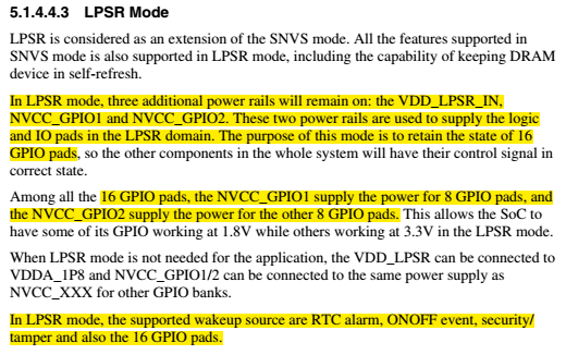

We want to use LPSR mode of i.MX7S.
And we want to wake-up a system by an interrupt from GPIO.
The following is explained in a reference manual.
GPIO1_IO00-IO07 are supplied power to by NVCC_GPIO1, and GPIO1_IO08-IO15 are supplied power to by NVCC_GPIO2.
GPIO1_IO00-IO07 are explained in LPSR.
 - 8.2.5 IOMUXC LPSR Memory Map/Register Definition
However, GPIO1_IO8-IO15 are explained in the following(not LPSR).
 - 8.2.7 IOMUXC Memory Map/Register Definition
It seems that those are not included in LPSR,
Can GPIO1_IO8-IO15 be used as a wake-up source from LPSR mode?
May I have advice?
yes. GPIO1_IO00-IO07 are explained in LPSR since it may have alternative
iomux settings in LPSR.
igor

We checked about these GPIOs in LPSR mode.
NVCC_GPIO1 and NVCC_GPIO2 are supplied power to by VDD_LPSR(1.8V).
In LPSR mode,
GPIO1_IO00-GPIO1_IO07 can hold output High.
However, GPIO1_IO08-GPIO1_IO15 can not hold output High.(The output voltage drops to Low.)
Is there any necessary setting?
GPIO1_IO08-GPIO1_IO15 can be worked normally in LPSR mode?
When it is in RUN mode, GPIO1_IO08-GPIO1_IO15 works normally.
And I understand that GPIO1_IO08-GPIO1_IO15 can be used as wake-up source.
May I have advice?
Yuuki
yes they can be used. Note, it should be configured as inputs, not outputs.
