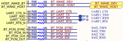

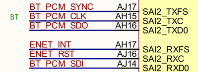

Hello, We are using AW_CM358 Wifi/BT module on our custom board with i.MX8MP.
Wifi and BT is operational and tested. But we can't configure the sound-card for the BT module. Here is our device tree snippets and log that we're having. Same error also exist for the codec we are trying to port from TI. Could you check what could be the issue?

The only way that I was able to replicate the issue on my side was disconnecting Wi-Fi/Bluetooth module from EVK board.
Could you please take look on schematic/layout side?
Also, which firmware are you loading?
Best regards.

Are you using this module?
Could you please try with our EVK?
Could you please share your schematic connection?
