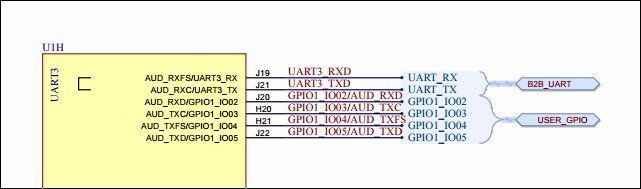

I'm using a custom i.mx6sl board running Linux 4.1.15 and trying to get bluetooth working. I'm using the following DTS settings:
MX6SL_PAD_AUD_RXFS__UART3_RX_DATA 0x1b0b1
MX6SL_PAD_AUD_RXC__UART3_TX_DATA 0x1b0b1
MX6SL_PAD_EPDC_BDR0__UART3_RTS_B 0x1b0b1
MX6SL_PAD_EPDC_BDR1__UART3_CTS_B 0x1b0b1
The problem I have is about configuring AUD_RXFS as UART3_RX and AUD_RXC as UART3_TX. The problem lies with IOMUXC_UART3_UART_RX_DATA_SELECT_INPUT. The datasheet says:
Route RX_DATA signal to pad when UART is in DCE mode. Route TX_DATA signal to pad when UART is
in DTE mode.
000 AUD_RXC_ALT2 — Selecting ALT2 mode of pad AUD_RXC for UART3_TX_DATA.
001 AUD_RXFS_ALT2 — Selecting ALT2 mode of pad AUD_RXFS for UART3_RX_DATA.
Does that mean I can't actually use AUD_RXFS as UART3_RX and at the same time have AUD_RXC as UART3_TX?
In testing, I'm seeing that I can't actually transmit anything on UART3 (ttymxc2).

I checked that physically the pinmux has been configured correctly except for the confusion around IOMUXC_UART3_UART_RX_DATA_SELECT_INPUT
a) check rx pin
# check IOMUXC_SW_MUX_CTL_PAD_AUD_RXFS is set to 2 ALT2 UART3_RX_DATA.
/unit_tests/memtool -32 0x020E0058 1
# check (IOMUXC_UART3_UART_RX_DATA_SELECT_INPUT) is set to 1 AUD_RXFS_ALT2 — Selecting ALT2 mode of pad AUD_RXFS for UART3_RX_DATA
/unit_tests/memtool -32 0x20E080C 1
0x020E0058: 00000002
0x020E080C: 00000001
b) check tx pin
# check IOMUXC_SW_MUX_CTL_PAD_AUD_RXC is set to 2 UART3_TX_DATA.
/unit_tests/memtool -32 0x020E0050 1
0x020E0050: 00000002
But IOMUXC_UART3_UART_RX_DATA_SELECT_INPUT can't be set to 0 since it needs to be set to 1 so that RXFS is UART3_RX.
I think this means that I made a design mistake when selecting AUD_RXFS and AUD_RXC as the pads for UART3_RX and TX on this board and that means I won't be able to get this to work unless I find new pads that can carry UART3_RX and TX without conflict.
I would appreciate confirmation or advice/suggestions on this.
Thanks!

jayakumar2
Contributor V
Hello gusarambula,
Thanks for your reply. Just to confirm, are you 100% sure there is a conflict in this configuration for UART3 using AUD_RXFS/RXC? The reason I ask is because I see the mx6sl Warp board reference design ( http://revotics.com/assets/warp/WaRP_Mainboard_r1.11_Schematics.PDF  )used the same AUD_RXFS/RXC pins that I'm using for UART3 (pic attached).  Did that board have a problem?
In addition, I also just tried setting it up with Pin Tools v3.0.2 and that doesn't give any error when I set up AUD_RXC and AUD_RXFS as UART3, it says the configuration is valid. It generates the following pin_mux.c
HW_IOMUXC_SW_MUX_CTL_PAD_AUD_RXC_WR(IOMUXC_BASE,
BF_IOMUXC_SW_MUX_CTL_PAD_AUD_RXC_MUX_MODE(BV_IOMUXC_SW_MUX_CTL_PAD_AUD_RXC_MUX_MODE_ALT2)); /* MUX Mode Select Field: Select signal UART3_TX_DATA.- Configure register IOMUXC_UART3_UART_RX_DATA_SELECT_INPUTSelect Input Register for mode ALT2. */
HW_IOMUXC_SW_MUX_CTL_PAD_AUD_RXFS_WR(IOMUXC_BASE,
BF_IOMUXC_SW_MUX_CTL_PAD_AUD_RXFS_MUX_MODE(BV_IOMUXC_SW_MUX_CTL_PAD_AUD_RXFS_MUX_MODE_ALT2)); /* MUX Mode Select Field: Select signal UART3_RX_DATA.- Configure register IOMUXC_UART3_UART_RX_DATA_SELECT_INPUTSelect Input Register for mode ALT2. */
HW_IOMUXC_UART3_UART_RX_DATA_SELECT_INPUT_WR(IOMUXC_BASE,
BF_IOMUXC_UART3_UART_RX_DATA_SELECT_INPUT_DAISY(BV_IOMUXC_UART3_UART_RX_DATA_SELECT_INPUT_DAISY_AUD_RXC_ALT2)); /* Input Select (DAISY) Field: Selecting ALT2MUX Mode Select Field. mode of pad AUD_RXC for UART3_TX_DATA. */
That's the same settings I have been using.
Thanks!

gusarambula
Hello Jaya Kumar,
My apologies. I checked with the Pins Tool and the alternative you mention should work correctly. I had tested it and there is a conflict with certain configurations but the one you mentioned looks valid according to the Pins Tool. It should work correctly.
I hope this helps!
