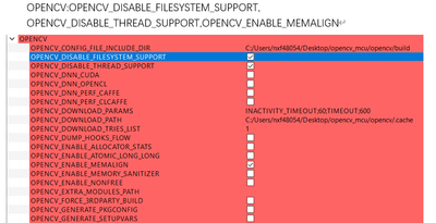

jingpan
Hi @kowshik1729 ,
Please make sure CMAKE version is cmake-3.10.2-win64-x64. Other version can't get good result. THREAD support must be disabled.
Jing

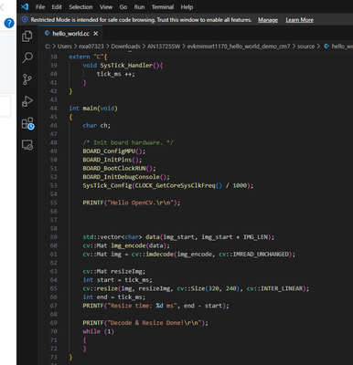

kerryzhou
Hi @kowshik1729 ,
  What's the code you are using now? the AN13725 attached software directly?
https://www.nxp.com/docs/en/application-note-software/AN13725SW.zip

kowshik1729
With all due respect, have you cross checked the content of the zip you've sent vs the content of the appnote?
There should be fake_root, opencv sources etc., present in that zip as per the appnote but the sw you've shared is a hello world expresso project. Please cross check and let me know.

kerryzhou
Hi @kowshik1729 ,
  AN13725SW is for the AN13725, it is also used the opencv:
That's why I ask what the code you are running, we need more information for your issues.
