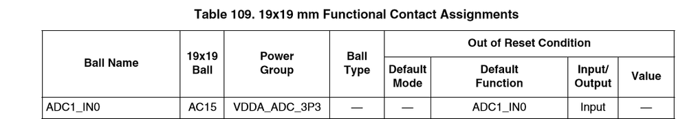

Hi Everyone,
I want to read the ADC value for the below pin ADC1_IN0 that we can read from the user space. my expetion is to get interface like sysfs gpio so i can export and use it.
Since this pin marked as Input so anyone suggest me how to read the value for this pin from userspace.
running linux (yocto zeus) on the imx board. One can access the datasheet from below link
https://www.nxp.com/docs/en/data-sheet/IMX6SXAEC.pdf  (Page 137 Table 113).

igorpadykov
Hi Nikhil
unfortunately for i.MX6SX there is no linux adc support in nxp bsps and one can use FreeRTOS:
Alternatively one can try to reuse i.MX7D linux adc driver, it is described in
sect.4.1.3 ADC Driver Overview i.MX Linux Reference Manual
igor
