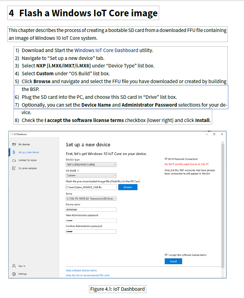

hi..
my board : 8MMINIKPD4
OS : window 10 IOT
Followed the documentation IOT Dashboard on micro SD Card

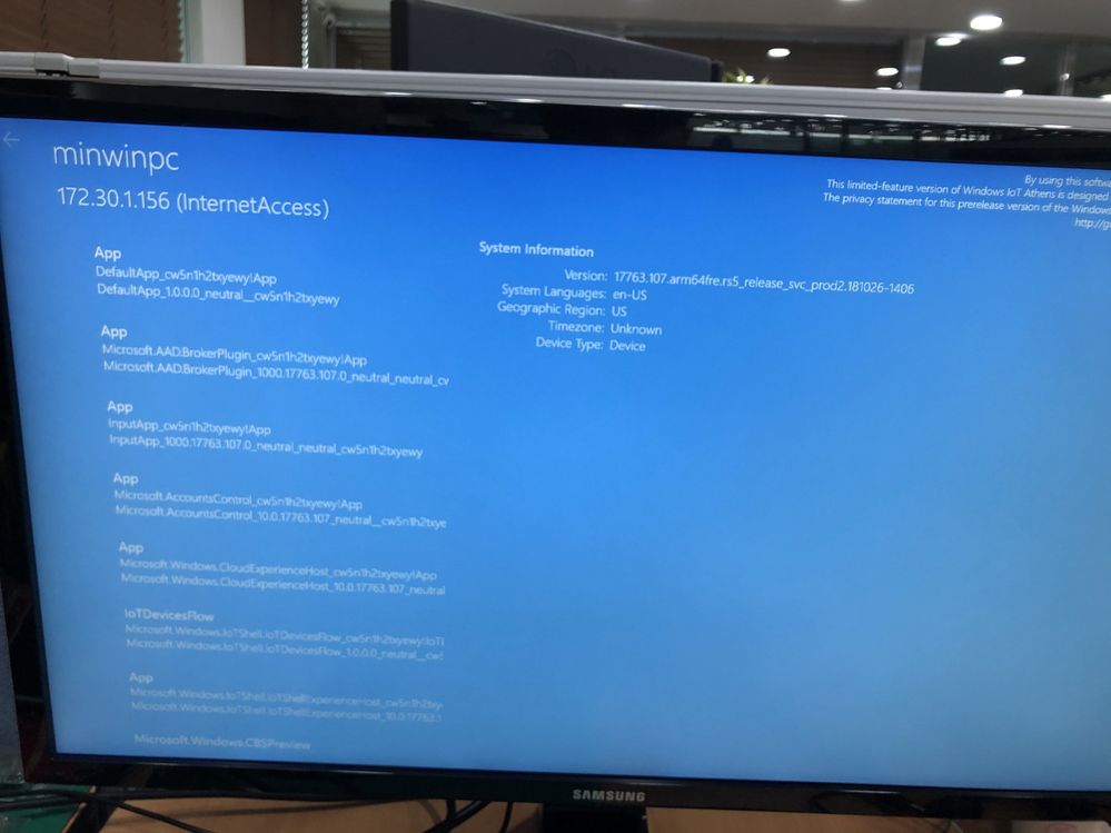

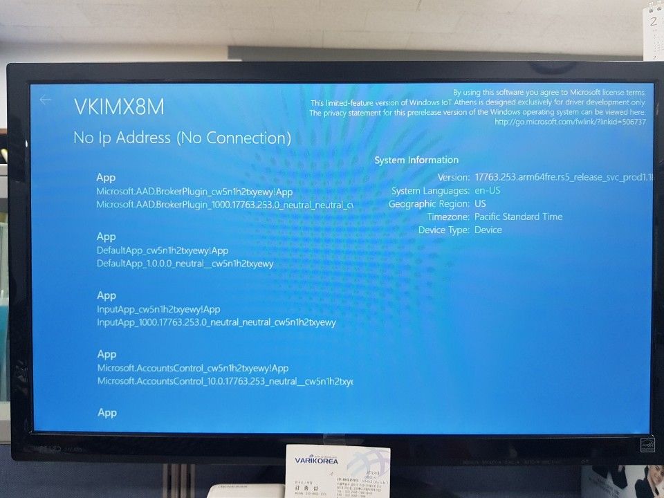

But I could not see the Windows10 IOT screen
The final screen I want is the screen below
please advise.

Frantisek_Prochaska
although the application is not provisioned for arm64 architecture by Microsoft, it can still be added to the product if needed.
However the dashboard is still accessible from web browser over http so you might not necessarily need the app. The IP address for accessing the page can be read on the blue info screen you have posted.
How to add the app to custom project:
  1. Build and import BSP into “IoT ADK AddonKit” as described “Building Windows 10 IoT Core for NXP i.MX” chapter of i.MX_Win10_User's_Guide.pdf .
  2. Build the Windows 10 IoT Core Default App for arm64
    1. For the build I would recommend to use release configuration to avoid need of debugging libs
    2. APPX could be created from the right click on project menu that pops up in Visual Studio by selecting “store->Create App Package”
  3. Provision the imported BSP with created APPX package by “Add-IoTAppxPackage path_to.appx fga app_name_to_be_displayed” command.
    1. Note the “fga” argument specifies application to run in foreground.
    2. The command is available at: https://docs.microsoft.com/en-us/windows-hardware/manufacture/iot/deploy-your-app-with-a-standard-bo...
  4. Create test ffu and create new SD card. You can continue following the https://docs.microsoft.com/en-us/windows-hardware/manufacture/iot/deploy-your-app-with-a-standard-bo....

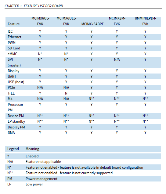

I have a question.
Can I use the following features when running as a custom application?
Required features are I2C, Ethernet, SPI, and UART.
9,995 Views
Frantisek_Prochaska
Yes, of course. Applications can access I2C, SPI and UART and I see you have the notice about "internet access" on the screen too. To get the idea about features I would recommend checking GitHub - microsoft/Windows-iotcore-samples: Official code samples repository for Windows 10 Internet...  and the documentation available from Microsoft.

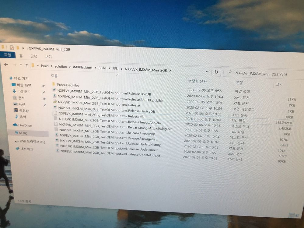

alzip79
hi, Frantisek Prochaska
  1. “Building Windows 10 IoT Core for NXP i.MX” chapter of i.MX_Win10_User's_Guide.pdf  chapter 10.1 ~ 10.1.3.1
I created FFU file
I used the iot dashboard to put the FFU file on the SD card.
However, the screen below appears the same.
What did I miss?

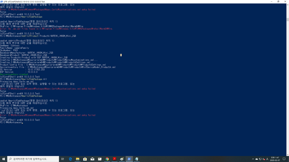

i tried more..
chapter 10.1.4 Building the FFU with the IoT ADK AddonKit
I refer to the page below and got an error in the Build Packages item in progress.
Lab 1a: Create a basic image | Microsoft Docs

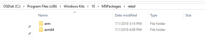

Frantisek_Prochaska
Hi An,
the error you have got looks strange to me. I would try to do two things here:
  1. Check that you have installed of Windows10_IoTCore_Packages from iso file for arm64. However I am sure you have it because Visual Studio builds everything correctly.
    • I have the following files on my disk:pastedImage_1.png
      • There are no *.wm.xml files inside arm64 directory on my machine though so I believe the second idea will work
  2. Revert iot-adk-addonkit to commit revision 52fa36327498bf1394970ef7572142b8a69ec304
    1. Open git shell inside iot-adk-addonkit directory.
    2. Execute git reset --hard 52fa36327498bf1394970ef7572142b8a69ec304
    3. Try to redo the Lab 1a: Create a basic image | Microsoft Docs
      • I am a little curious here: Do you add anything besides the BSP and possibly Import-IoTOEMPackage Recovery.* ?
    4. If New-IoTCabPackage All step succeeds you can continue adding your appx, but it's better to finish the Lab 1a just to be sure. And return after the ffu is created successfully.
      • Add-IoTAppxPackage path_to.appx fga app_name_to_be_displayed
    5. Create product and assemble custom ffu.
    6. Put ffu on SD card
9,995 Views
