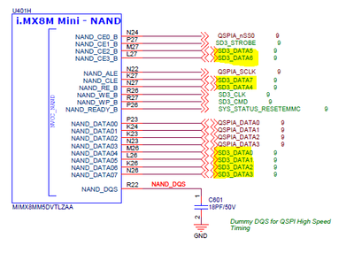

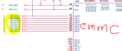

We follow 8MMINID4 to design a new HW and replace NAND to eMMC as below.
We can update image successfully by using UUU tool. Please check UUU log and uuu.auto for command list.
After reboot, it will hang up at u-boot and complain "MMC Device 1 not found".
Can you help to check and advise?

In U-boot prompt, we can found eMMC device at port2.
log:
u-boot=>
u-boot=> mmc list
FSL_SDHC: 2
u-boot=> mmc dev 1
no mmc device at slot 1
u-boot=> mmc dev 2
switch to partitions #0, OK
mmc2(part 0) is current device
u-boot=>

Rita_Wang
In the software the uSDHC3 clock is not initialized in default. We must let CONFIG_SYS_FSL_USDHC_NUM=2 to run the uSDHC3 clock initialization code. How to add you can refer to the thread by my colleague.

KennyChu
@Rita_Wang
Thanks a lot. It can enter kernel now.

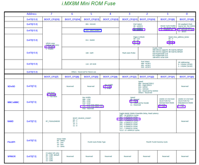

KennyChu
We are using uSDHC3. You can check ROM Fuse map below.
