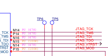

Hi Igorpadykov,
Other than CCM_CLKO1,2 any other PLL pin possibilities to generate 8MHz clock out.
In above image CCM_CLKO1,2 are connected JTAG pins(JTAG_TMS and JTAG_TDO) Since JTAG  pins N15 or P14 has been used for 8MHZ clock, will that be conflicting when we use JTAG. So any other pins for 8MHz clock generate.

But I didn't see any clock divider option on a sec.18.7.18 for 8MHz
1,878 Views
igorpadykov
one can try to output AUDIO_PLL (reprogram it to necessary frequency
using CCM_ANALOG_PLL_AUDIOn register) and dividers in AUDIO_DIV_LSB(MSB)
CCM_ANALOG_MISC2n.
igor

igorpadykov
Hi prabhu
as another alternative one can consider LVDSCLK1 (CCM_CLK1_N, CCM_CLK1_P balls)
described in sect.18.7.18 Miscellaneous Register 1 (CCM_ANALOG_MISC1n) i.MX6ULL Reference Manual
https://www.nxp.com/webapp/Download?colCode=IMX6ULLRM
