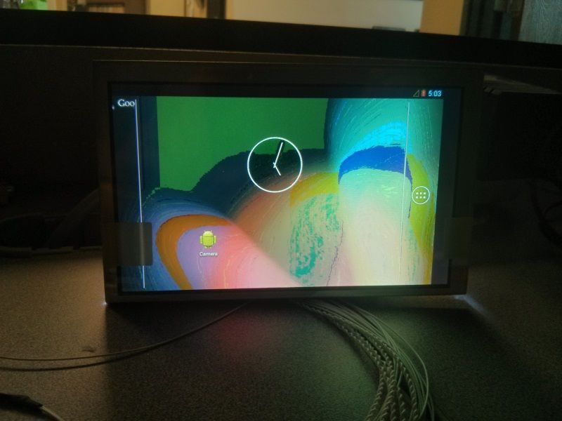

I have a 24bit LVDS display that I am running on a custom imx6q board.  The images look like they are being displayed at the wrong color depth and have some odd horizontal scan line artifacts.

Hi Doug,
you can try to set the correct display setup in u-boot bootargs by adding: video=mxcfb0:dev=ldb,LG-WVGA,if=RGB24 ldb=sin0
However, by viewing the posted image, there may be a problem of clock polarity, you can try change your display setup with:
static struct fb_videomode ldb_modedb[] = {
  "LG-WVGA", 60, 800, 480, 30066, /*DE mode only. horizontal blanking 256 (85 + 85 + 86), vert blanking 45 (15 + 15 + 15) */
  85, 85,
  15, 15,
  86, 15,
  FB_SYNC_CLK_LAT_FALL,
  FB_VMODE_NONINTERLACED,
  FB_MODE_IS_DETAILED,},
About the custom cable,the successful implementation of the cable is fundamental.
