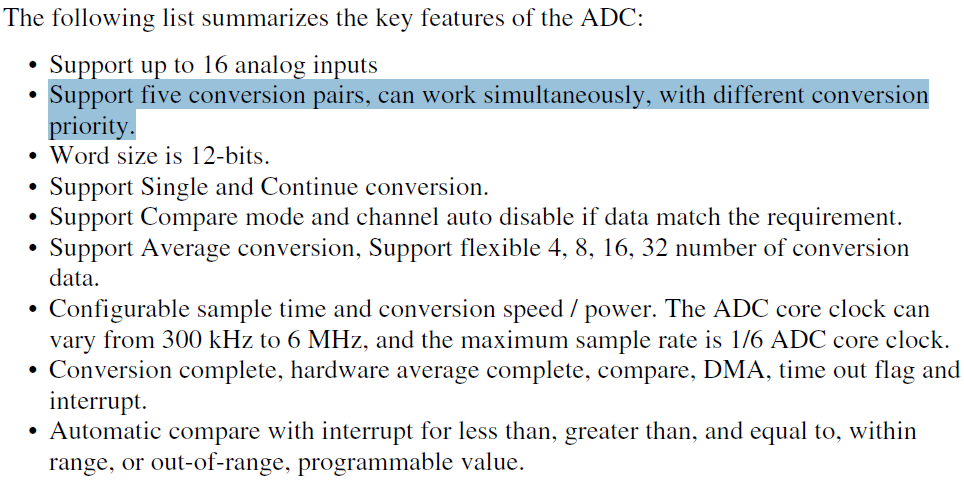

I want to run 2 adc simultaneously in conversion but it does not work with Imx7 phycore .
I succeded to function with one adc ,now I use the adc1_in3 and adc1_in2 with the configuration channel A for conversion 1 and channel B for conversion 2.Just my conversion 1 interruption work,i don't know the problem.
It is possible that there is a conflict between the two channels?
Thank you in advance

Hello Antoine,
    Every ADC channel has their own prioriy, see below items from reference manual, please!
Hope above information is helpful for you!
