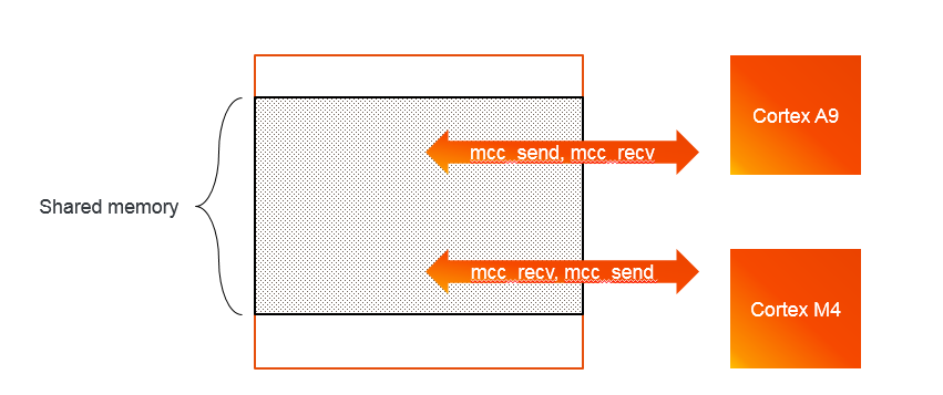

  • MCC works with shared memory area
  • Communication is performed through ‘send’ and ‘receive’ functions
Shared memory Cores communicate through shared memory

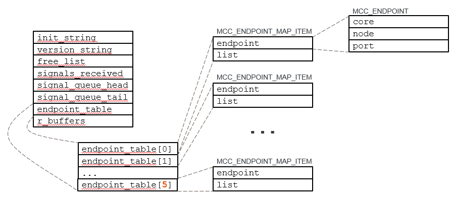

Core structures of the MCC  MCC_ENDPOINT
core
  • Identifies a processor core, A9 is 0 and M4 is 1.
node
  • In Linux, each process using MCC has its own node number. MQX has only one node number.
port
  • Any number of ports per node is allowed.
  • Value MCC_RESERVED_PORT_NUMBER is not allowed.
The number of endpoints in system is defined during compile time by macro MCC_ATTR_MAX_RECEIVE_ENDPOINTS.
MCC_BOOKEEPING_STRUCT Endpoint table I.
