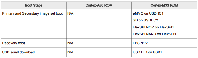

In this document you'll find an example on how to build your own flash.bin for i.MX93 low power mode where only the Cortex-M33 rom is running after Power-On Reset, the following table provides the boot devices supported for LP boot:
In LP boot, up to three containers (NXP and OEM containers) are expected to be handled by CM33 ROM code.
