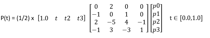

For example, there is four control point p0, p1 , p2 , p3,  to draw the curve pass through all of them, it could divide to segment p0 to p1 , segment p1 to p2 , segment p2 to p3.
For segment p1 to p2 , select four control point as p0,p1, p2, p3, use Catmull-Rom Splines as below:

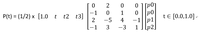

For segment p0 to p1 , need use four control point as p0, p0, p1, p2:

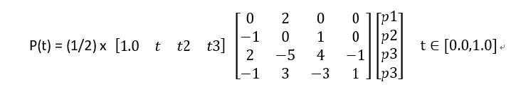

For segment p2 to p3, need use four control point as p1, p2, p3, p3:
