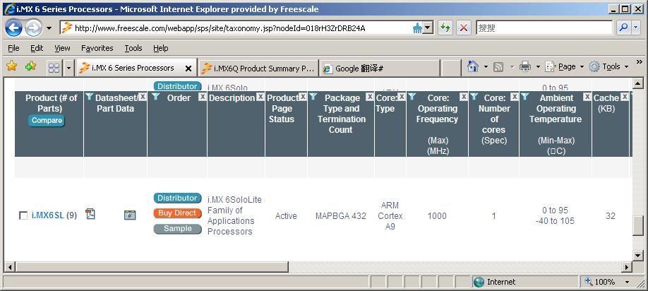

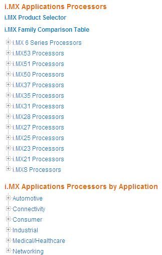

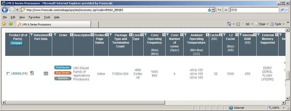

          We can enter Freescale i.MX website by the follow link http://www.freescale.com/imx, and after we input it into the IE address, it will remap to the new address of http://www.freescale.com/webapp/sps/site/homepage.jsp?code=IMX_HOME&tid=vanIMX.

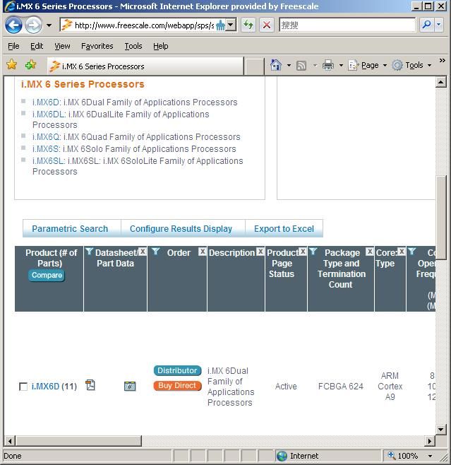

And the website page will have all the i.MX chipsets access web link like the follows:

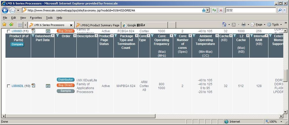

      And if we enter the i.MX6 serials Processors web link http://www.freescale.com/webapp/sps/site/taxonomy.jsp?code=IMX6X_SERIES , we will get the page like the follows:
       Which have all the i.MX6 serials processors feature lists and website links.

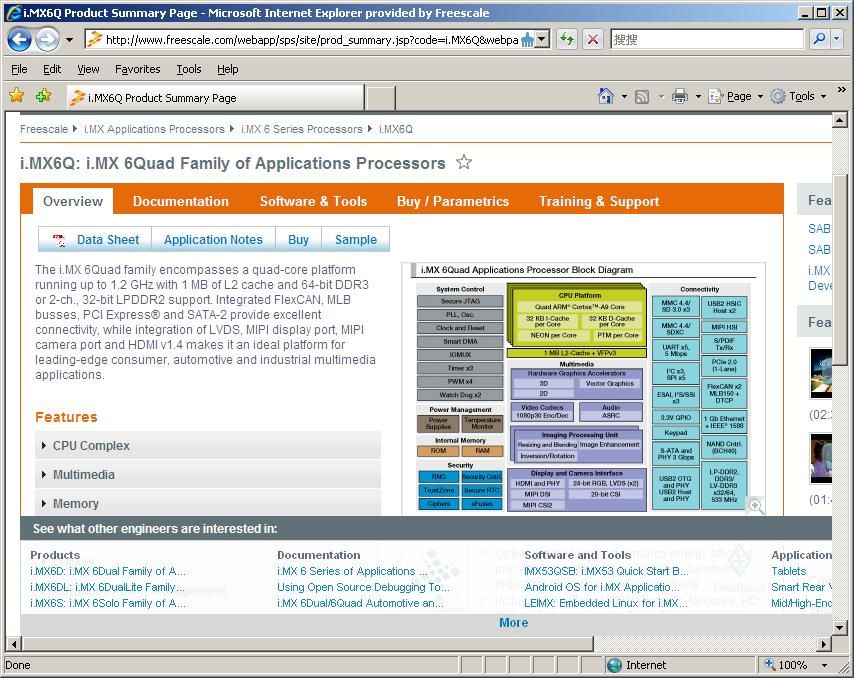

We enter the i.MX6D/Q web link
http://www.freescale.com/webapp/sps/site/prod_summary.jsp?code=i.MX6Q&webpageId=129226228141673454B2...
its main page as follows:
   The Documentation and Software&Tools items is very important to get the design resource, and the Buy/Parametrics item will have the development board and chipset order information

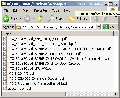

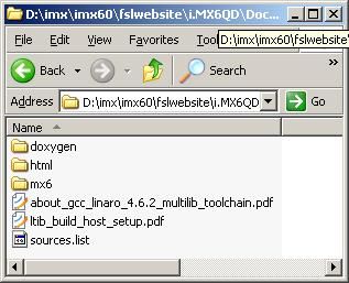

1.1.7  i.MX6Q/D BSP/Codec Software Document

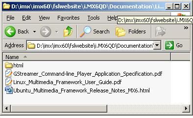

L3.0.35_4.0.0_LINUX_DOCS
i.MX 6Quad, i.MX 6Dual, i.MX 6DualLite and i.MX 6Solo Linux BSP Documentation. Includes Release Notes, Reference Manual,...
MX6 folder include the BSP release notes, reference manual, user guide and other APIs doc.

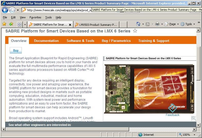

SABRE Platform for Smart Devices Based on the i.MX 6 Series
The Smart Application Blueprint for Rapid Engineering (SABRE) platform for smart devices allows you to hold in your hands and evaluate the full multimedia performance capabilities of i.MX 6 series applications processors based on ARM® Cortex™-A9 technology.  Targeted for any device ...
Enter it:
Press Buy:

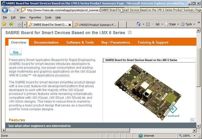

SABRE Board for Smart Devices Based on the i.MX 6 Series
Freescale's Smart Application Blueprint for Rapid Engineering (SABRE) board for smart devices introduces developers to quad-core processing, low-power consumption and leading-edge multimedia and graphics applications on the i.MX 6Quad ARM ® Cortex™ -A9 applications processor. The SABRE board for smart devices ...
Enter it:
Press Buy:
  SDB board share the same PCB with SDP, but have no camera, LVDS and GPS moduel.

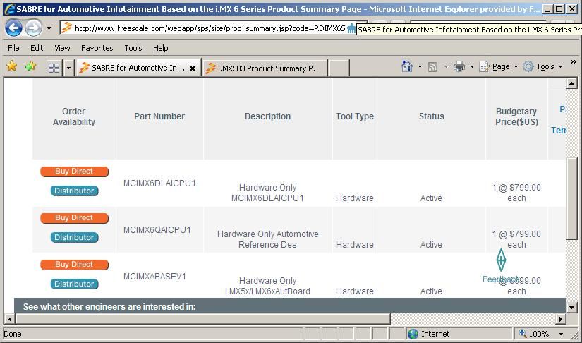

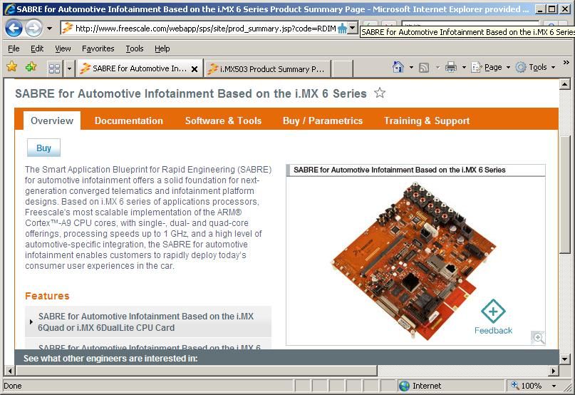

SABRE for Automotive Infotainment Based on the i.MX 6 Series
The Smart Application Blueprint for Rapid Engineering (SABRE) for automotive infotainment offers a solid foundation for next-generation converged telematics and infotainment platform designs. Based on i.MX 6 series of applications processors, Freescale's most scalable implementation of the ARM® Cortex™-A9 CPU ...
Enter it:
Press Buy:
   Which have the CPU board and automotive base board, And if need the automotive board LVDS display panel, we can enter the i.MX53 automotive board link to get the order name.

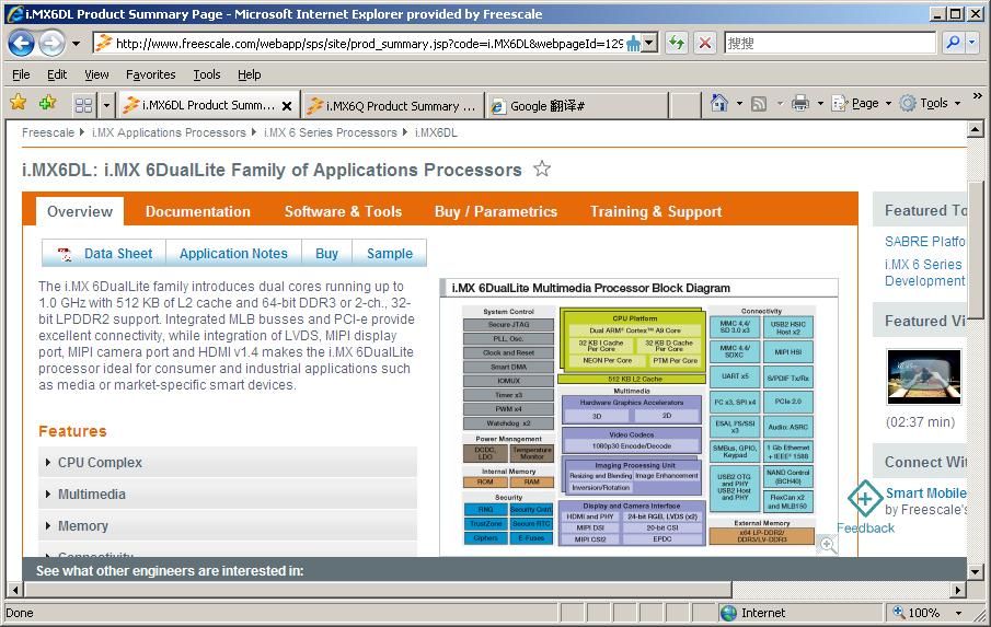

2       i.MX6DL/S website guide.
We enter the i.MX6DL/S web link
http://www.freescale.com/webapp/sps/site/prod_summary.jsp?code=i.MX6DL&webpageId=129226228141673454B...
2.1    i.MX6DL/S Documentation
http://www.freescale.com/webapp/sps/site/prod_summary.jsp?code=i.MX6DL&nodeId=018rH3ZrDRB24A&fpsp=1&...
