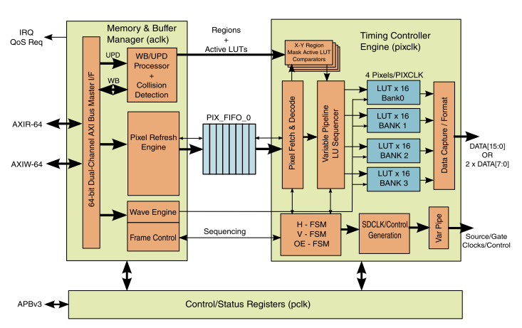

What's TCE underrun
TCE is Timing Controller Engine which is responsible for TFT scan frame refreshes. The pixel FIFO (PIX_FIFO) is used to load working buffer pixel data for TCE. When FIFO underrun, TCE_UNDERRUN_IRQ interrupt is triggered, and TCE underrun log pops up in kernel log.
The pixel data is processed by TCE to generate TFT voltage control pixels for panel. If an underrun occurs, unknown data is used and that can damage the panel.
