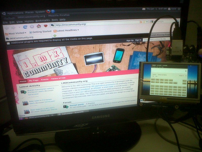

Results
The following picture shows the i.MX 53 QSB running the extended desktop previously configured.
You can see the VGA monitor with a Firefox instance and the SEIKO LCD display with a calc instance.

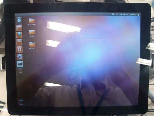

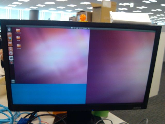

I want to use ubuntu with dual display on i.mx6q board.
And i what to use LVDS as the primary dispaly and use HDMI as the second one.
My u-boot's kernel parameters is bellow:
video=mxcfb0:dev=ldb,LDB-XGA,if=RGB666 video=mxcfb1:dev=hdmi,1920x1080M@60,if=RGB24
And my x window configure file is as bellow:
Section "InputDevice"
        Identifier      "Generic Keyboard"
        Driver          "kbd"
        Option          "XkbRules"      "xorg"
        Option          "XkbModel"      "pc105"
        Option          "XkbLayout"     "us"
EndSection
        Identifier      "Configured Mouse"
        Driver          "mouse"
        Option          "CorePointer"
EndSection
Section "Device"
        Identifier      "LVDS"
       Driver          "vivante"
        Option          "fbdev"         "/dev/fb0"
       Option          "vivante_fbdev" "/dev/fb0"
       Option          "HWcursor"      "false"
EndSection
Section "Device"
        Identifier      "HDMI"
        Driver          "fbdev"                        ///////////////  If i use "vivante", X window start will failed, it seems that "vivante" not support two display?
        Option          "fbdev"         "/dev/fb2"
EndSection
Section "Monitor"
        Identifier      "LVDS Monitor"
EndSection
Section "Monitor"
        Identifier      "HDMI Monitor"
EndSection
Section "Screen"
        Identifier      "LVDS Screen"
        Monitor         "LVDS Monitor"
        Device          "LVDS"
EndSection
Section "Screen"
        Identifier      "HDMI Screen"
        Monitor         "HDMI Monitor"
        Device          "HDMI"
EndSection
Section "ServerLayout"
        Identifier      "Dual Layout"
        Screen 0        "LVDS Screen"
        Screen 1        "HDMI Screen" RightOf "LVDS Screen"
        Option          "Xinerama"  "on"
EndSection
Then i get the two display worked, But somthing is wrong.
On the left of HDMI display there is a copy of lvds.
Is my settings wrong?
Do you know about this?
