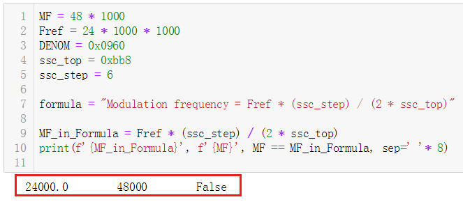

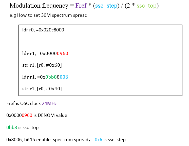

I'm confused about attached "spread spectrum.docx"
  1. Why CCM_ANALOG_PLL_SYS_NUM is not used in your scripts & document? and how to used it?
  2. ssc_top should be ssc_stop in page 4?
  3. In page 3:
              the modulation frequency is controlled about 48k.
       In Page 4:
              the formula "Modulation frequency = Fref * (ssc_step) / (2 * ssc_top)" is not matched with demo code: 24000 ≠ 48000

please refer to the new doc  attached on the top
Please fix the typo "ssc_top" --> "ssc_stop" in spread spectrum.docx
