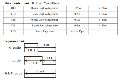

From WS2812  LED datasheet, we can see the timing must be precise, that is the reason we will use the Cortex M33 (Real time applications):
As we can see, the timing just accept tolerance of 150ns, that is the reason is preferred to use the Cortex M33 instead of control with Linux that is in charge of other tasks.

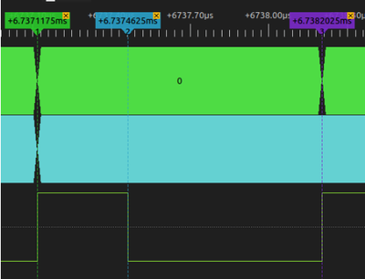

Testing and measuring the toggle timing with the RGPIO driver of Cortex M33, we could find the best number of NOP instructions to adjust with the required timing according to datasheet, and the results with core running at 200MHz are:
Parameter
Number of NOP times
HIGH_ONE_CYCLES
22  (T1H: 700 ns)
LOW_ONE_CYCLES
12  (T1L: 600 ns)
LOW_ZERO_CYCLES
20  (T0L: 800 ns)
HIGH_ZERO_CYCLES
6    (T0H: 350 ns)
Zero:
One:

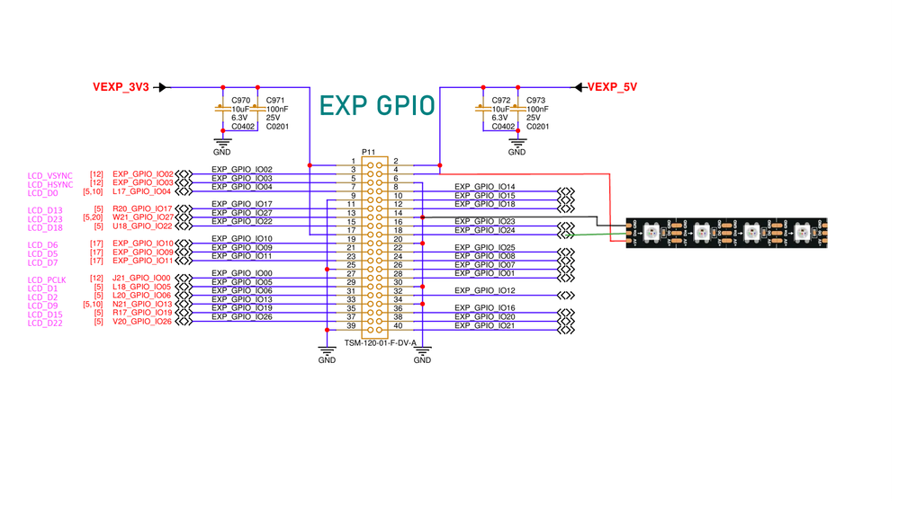

In this example, the EXP_GPIO_IO24 of FRDM-IMX93 was used to control the LED Strip.

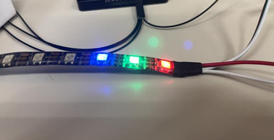

Finally, we are ready change colors of the LEDs:
Load the buffer (LED 1 = RED, LED 2 = Green, LED 3 = Blue).
root@imx93evk:~# wsled -c 0x55 0x00 0x00 -n 1
root@imx93evk:~# wsled -c 0x00 0x55 0x00 -n 2
root@imx93evk:~# wsled -c 0x00 0x00 0x55 -n 3
Show colors on LEDs.
root@imx93evk:~# wsled -t
