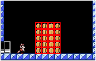

Object Detection: Template Matching Sample:
This sample was taken for testing proposes from:
http://docs.opencv.org/2.4.9/modules/imgproc/doc/object_detection.html#matchtemplate
What does this program do?
  • Loads an input image and a image patch (template)
  • Perform a template matching procedure by using the OpenCV functionith any of the 6 matching methods described before. The user can choose the method by entering its selection in the Trackbar.
  • Normalize the output of the matching procedure
  • Localize the location with higher matching probability
  • Draw a rectangle around the area corresponding to the highest match
Downloadable code: Click here

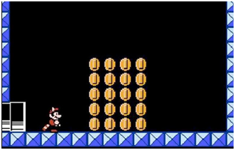

Testing our program with an input image such as:
$ ./DisplayImage name_of_your_test_image.jpg Template_image.jpg
  1. Ej. ./Display_image Mario.jpg Mario_coin.jpg
As example Test Image:
Template Image:
Results:
