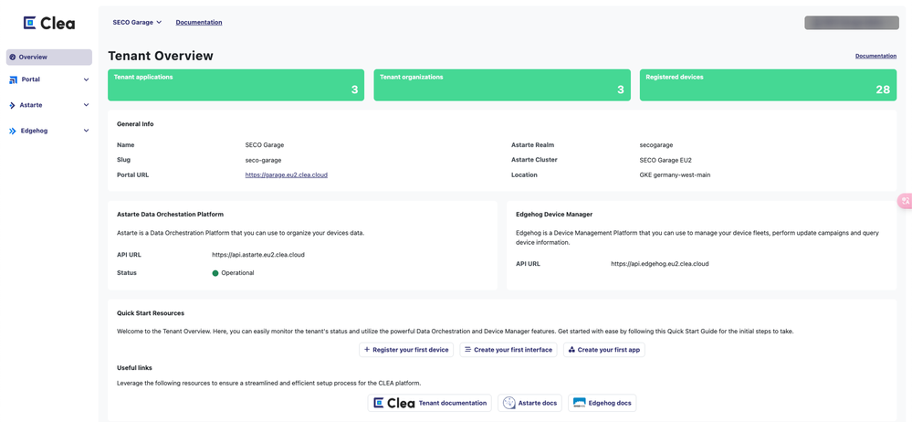

Log in to the Clea administration panel using the credentials provided via email, select the available tenant, and access its dedicated dashboard. The dashboard provides general information about the tenant, references to the Data Orchestration and Device Management components, and links to documentation resources.
On this page, save the Astarte API URL and the Pairing URL. To obtain the Pairing URL, append /pairing to the Astarte API URL.

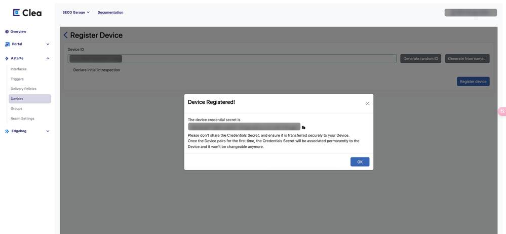

Navigate into Astarte Section and select the Devices section. Now click Register a New Device. The system will generate a:
  • Device ID and
  • Device Credential Secret.
These values must be copied and stored, as they will be required during device configuration.

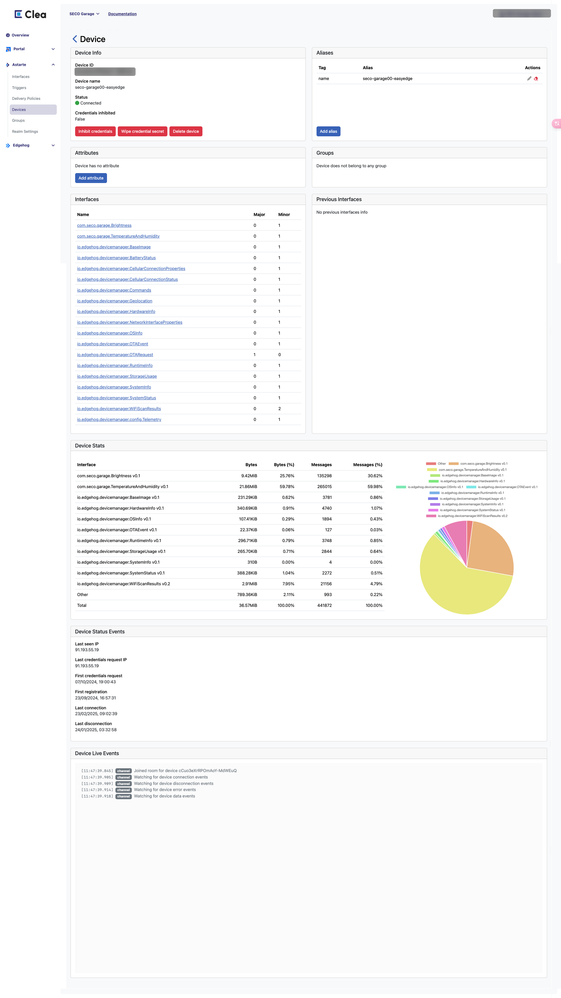

2.3         Verifying Device Data
After registration, verifying that the device is successfully transmitting telemetry and AI detection data is necessary.
To confirm data transmission, log into the Clea Admin Panel, navigate to the Edgehog section, and select Fleet to find the registered device. Selecting the device will provide access to system monitoring tabs, including:
  • Hardware Info
  • Operating System
  • Runtime
  • Base Image
  • System Status
  • Network Interface
  • Software Updates
To verify real-time data, navigate to Clea Astarte, click on Devices, select the device you registered, and scroll down until Device Live Events. Telemetry values such as CPU_Usage, CPU_Temperature, and Detection_Events should be updated approximately every 5 seconds.
In this section, you will see the data sent by the device.

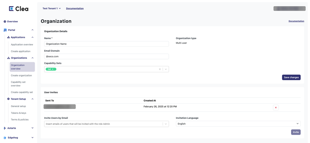

2.4         Login to the Clea Portal
Once data transmission is verified, the next step is to enable the web-based control application that visualizes detection results in the Clea Portal.
To access Clea Portal, you first need to create an Organization, which allows you to add users who can access the platform.

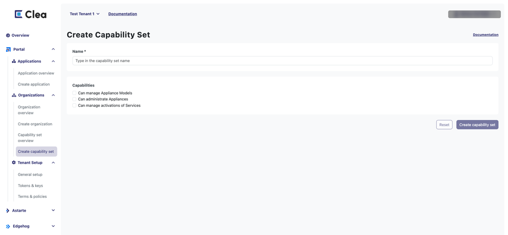

Before doing so, you must create a Capability Set to define the permissions for each Organization. To create one, click Create Capability Set in the Organization section. Enter a name and select the capabilities you want to enable.

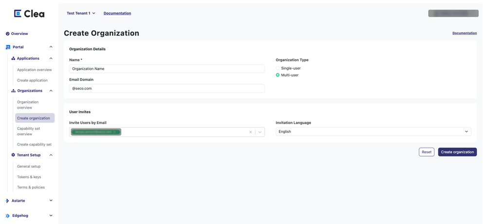

Then, click Create Capability Set to finalize its creation. Now, your first Capability Set is ready. Next, you need to create an Organization. Click on Create Organization.
Enter the organization’s name, and optionally specify an email domain. This will restrict registrations to emails belonging to that domain.
Choose whether the organization should be Single User or Multi User:
  • Single User: The organization consists of only one user.
  • Multi User: The organization can have multiple users.
Finally, enter the email address where you want to send the account invitation and select the preferred language for the invitation email.
Now, click on Create Organization. The invitation email will arrive within a few minutes.
Once the organization is created, assign the Capability Set in the designated field.

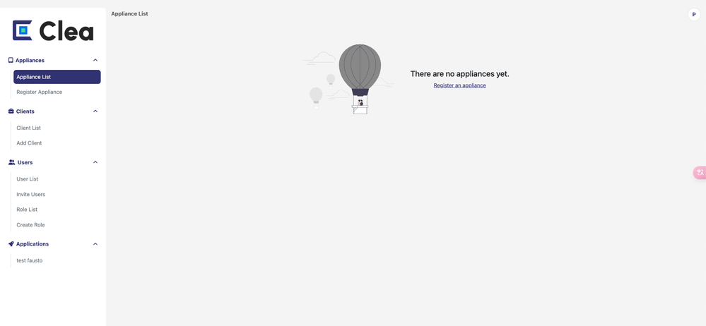

Once you accept the invitation, you will be logged into Clea Portal, the User Panel used by end users to view data sent by their devices. This panel will display only the devices belonging to their organization.
The first screen you will see is the Appliance List, which will initially be empty as no appliances have been registered yet.

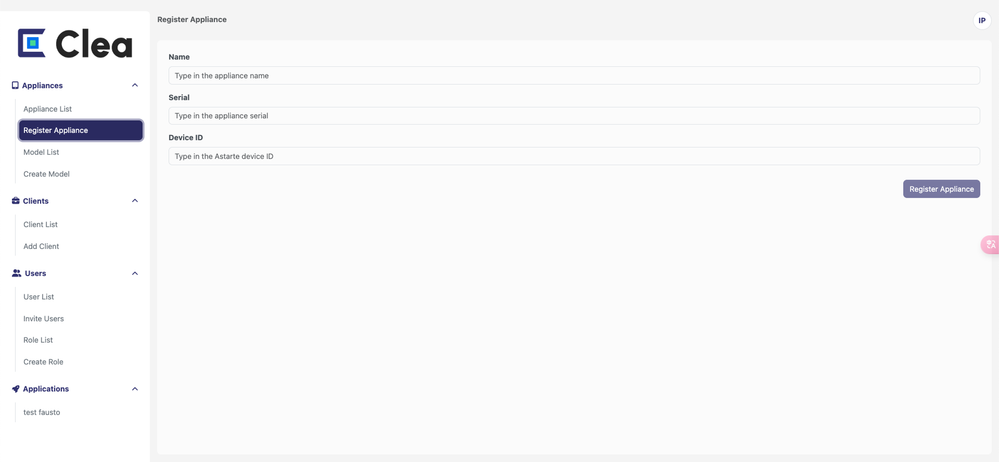

Now, let’s register the device you previously set up. Click on Register Appliance. Here, you will need to enter the following details:
  • Appliance Name: A name for the appliance you want to register.
  • Serial: This field is used to record an external serial number to identify the appliance, such as the serial number of the machine in which the device is installed or the serial number of the control unit connected to the device.
  • Device ID: The unique ID generated in the previous step.
After filling in the required fields, click Register Appliance. The appliance will then be connected and Online.

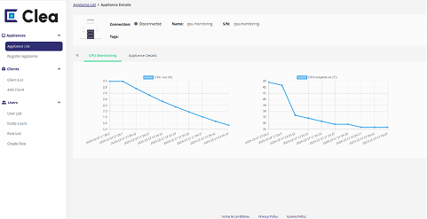

Here, a real-time dashboard will display:
  • Live CPU Usage & Temperature Data
Since CPU Usage Monitoring & Temperature is enabled by default, no additional setup is required for these metrics.
