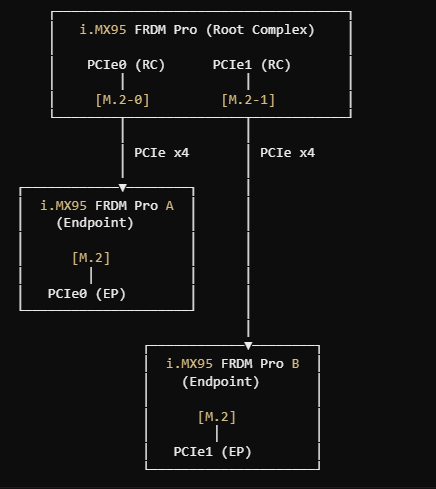

As part of the patches attached with this blog, we will relay the pcie write transaction from Endpoint-A to Endpoint-B connected to iMX95FRDM PRO.
Linux-imx used - lf-6.18.2-1.0.0
Attached are the following files:-
imx95-19x19-frdm-pro-pcie0-ep-dtbs - EP A shall use the dtb built with this dtbs
imx95-19x19-frdm-pro-pcie1-ep-dtbs - EP B shall use the dtb built with this dtbs
rc_pcie_dma_relay.c - driver used on RC to relay pcie write from EP-A to EP-B
conf_pcie0.sh - script to be executed on Endpoints A and B to configure the EPF driver

6. We are only using pcie0 M.2 Key M slots of Endpoint A and Endpoint B so you only need to upload this dtb to both the endpoint boards - imx95-19x19-frdm-pro-pcie0-ep.dtb and boot linux with it after passing 'iommu.passthrough=1' at uboot mmcargs. This is to disable smmu for our tests.
RC will boot with the default dtb - imx95-19x19-frdm-pro.dtb
7. Connect the Endpoint-A to RC's K1 via M.2 Key M to Key M cable. Similarly connect the other Endpoint-B to other RC's K2 M.2 slot via Key M to Key M cable.
8. Execute this script on both the endpoints - ./conf_pcie0.sh
9. Then reboot the RC iMX95 FRDM Pro and ensure that you see both the endpoints:-
0000:01:00.0 and 0001:01:00.0 are the enumerated endpoints.
