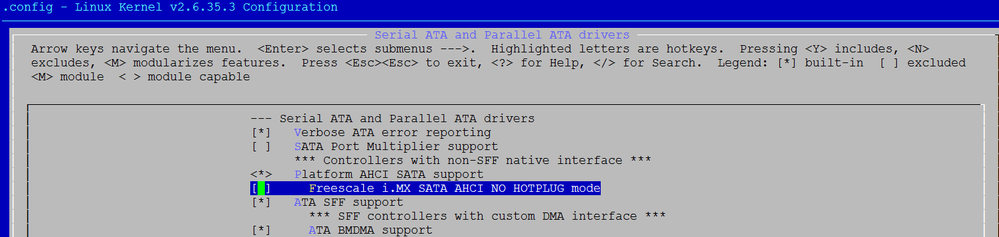

You can disable the following configuration when build the 2.6.35 kernel image
config SATA_AHCI_FSL_NO_HOTPLUG_MODE
        bool "Freescale i.MX SATA AHCI NO HOTPLUG mode"
        depends on SATA_AHCI_PLATFORM != n
        default n
        help
          In order to decrease the pwr consumption, release the CLK resources such as usb_phy1_clk, when there is no SATA device adaptored into the AHCI SATA port. The HOTPLUG feature can't be enabled in this situation. Please disable this option if the HOTPLUG is mandatory required.
          If unsure, say N.
BTW, I just verified the RFS on SATA on i.MX53 LOCO. It's ok.
