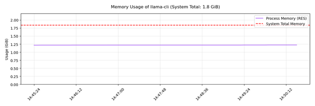

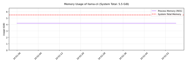

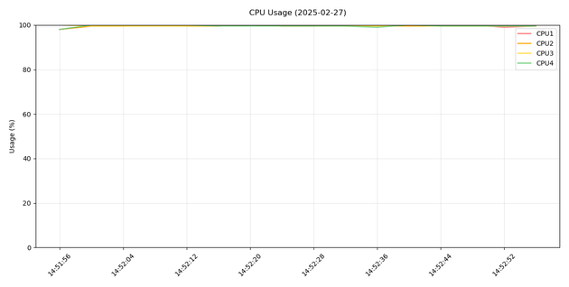

2. Results Analysis
The effects of different models on different boards were tested. It should be noted that the biggest obstacle limiting the running of the model on the board is memory.The test results including CPU and memory usage are as follows:
a. i.MX8mp + DeepSeek-R1-Distill-Qwen-7B-IQ4_XS
b. i.MX93 + DeepSeek-R1-Distill-Qwen-1.5B-Q4_K_M
After testing, the speed at which i.MX8MP runs DeepSeek-R1-Distill-Qwen-7B-IQ4_XS to generate tokens is about 1 token per second. The speed at which i.MX93 runs DeepSeek-R1-Distill-Qwen-1.5B-Q4_K_M to generate tokens is about 1.6 token per second.  The above test results for the generation speed are only rough test results and are for reference only.
The above icons show the CPU and memory usage of i.MX during the DeepSeek model running. It should be pointed out that the CPU efficiency affects the speed of model token generation. The memory size of the board limits whether the model can run in the corresponding development board. This is a balance between running speed and required memory size. Higher accuracy, such as using a 7B model, will result in a decrease in running speed.
