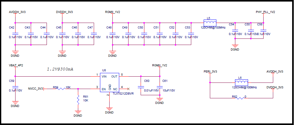

1. Schematic

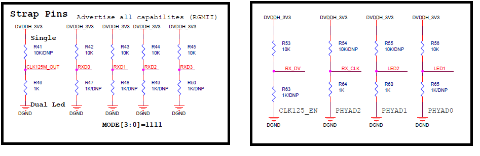

The MODE[3:0] strap-in pins are sampled and latched at power-up/reset. MODE[3:0]=1111 is RGMII mode - Advertise all capabilities (10/100/1000 speed half-/full-duplex)
The PHY address, PHYAD[2:0], is sampled and latched at power-up/reset. Here PHY address is set to 001.

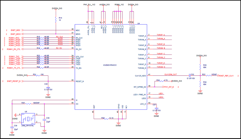

In this design example, the ENET_RESET_B is connected to GPIO pin GPIO1_IO03.
