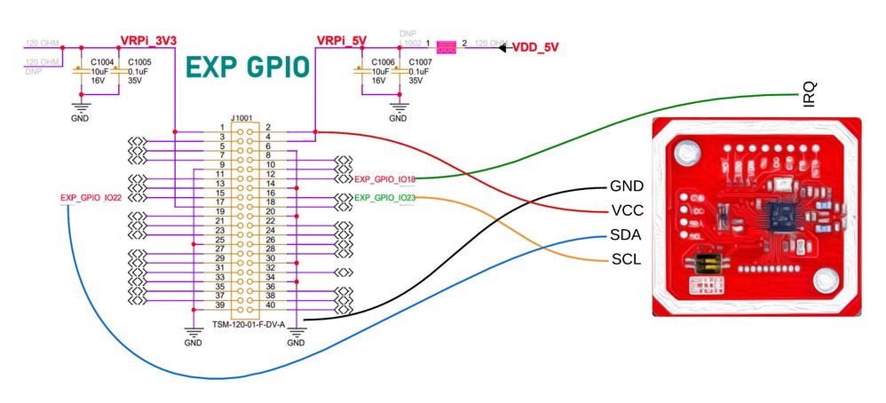

STEP 3 (Connection with PN532 MODULE).
For this example, we must connect the Module with the I.MX93 RP Header as follows:
I.MX93 SIDE
PN532 SIDE
GND
GND
VCC
VCC
GPIO_IO22
SDA
GPIO_IO23
SCL
GPIO_IO18
IRQ
