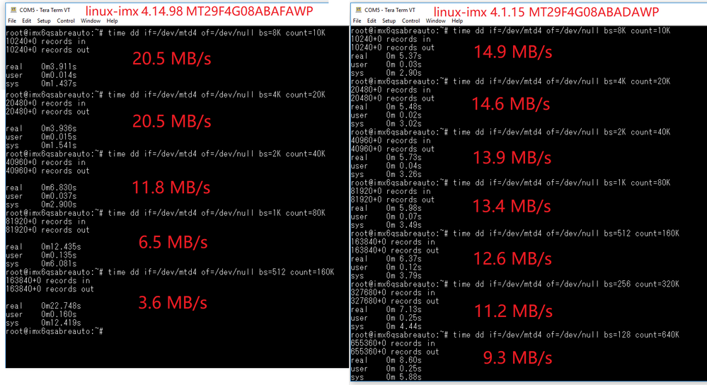

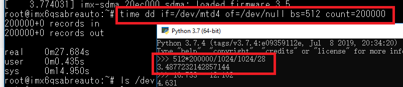

It's weird on our imx6d board: dd is much slower than mtd_speedtest, ~3.5MB/s vs ~20MB/s
P.S. EDO mode is 5 is enabled by linux-imx 4.14.98, without modifying source code.
For the dd command, I am pretty sure the "bs" argument (forced transfer size) is slowing down the transfer, see in this article: Tuning dd block size - tdg5
Can you please try a bigger one (200M for instance).
V.
vincent.aubineau‌, Thanks! It's about block_size:
