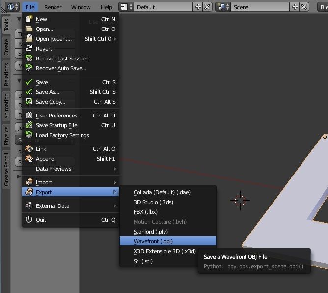

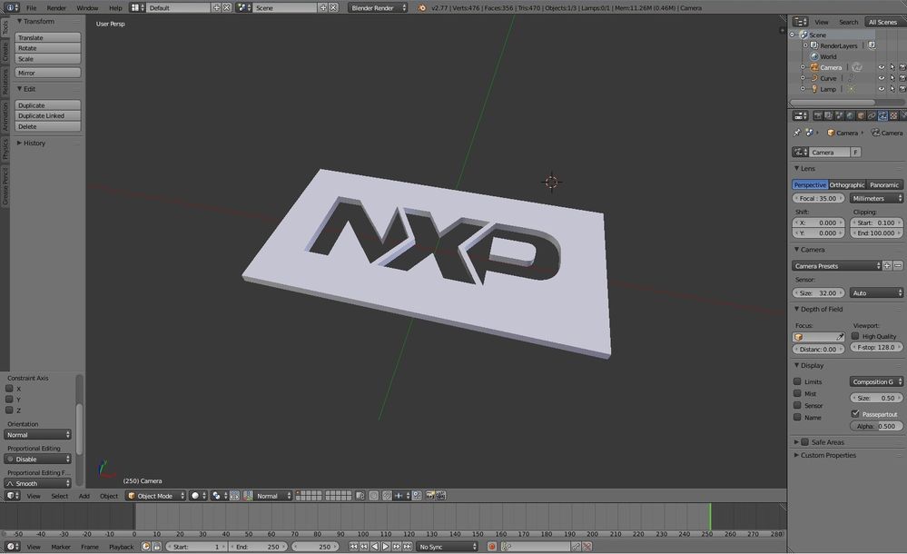

Step 1 - Exporting a model as .obj
You may import a 3D model from other sources or make your own simple 3D model in blender. For this example we’ll make a simple 3D NXP logo and export it.
Once you have your model ready, select the object in objet mode with a right click.
Once selected select File > Export > Wavefront (.obj)

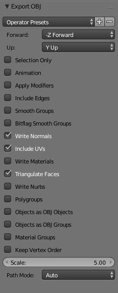

You may now select where and with what name to export the object file. On the left panel you will have the export options. It’s important to leave all options unchecked except for:
Write Normals
Include UVs
Triangulate Faces
(You may change the scale of your model and it won’t negatively affect the process)

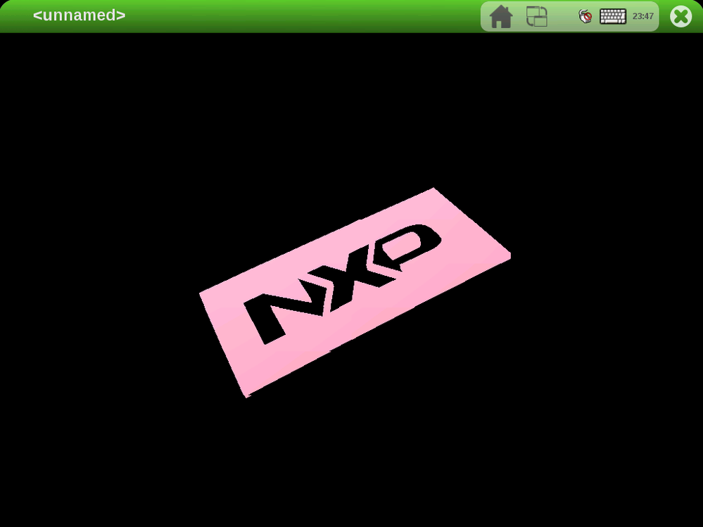

Once the program has compiled you can run it from the command prompt by using:
export DISPLAY=:0.0
./NXPlogo
The result will be as follows, where the 3D model is rotating,
