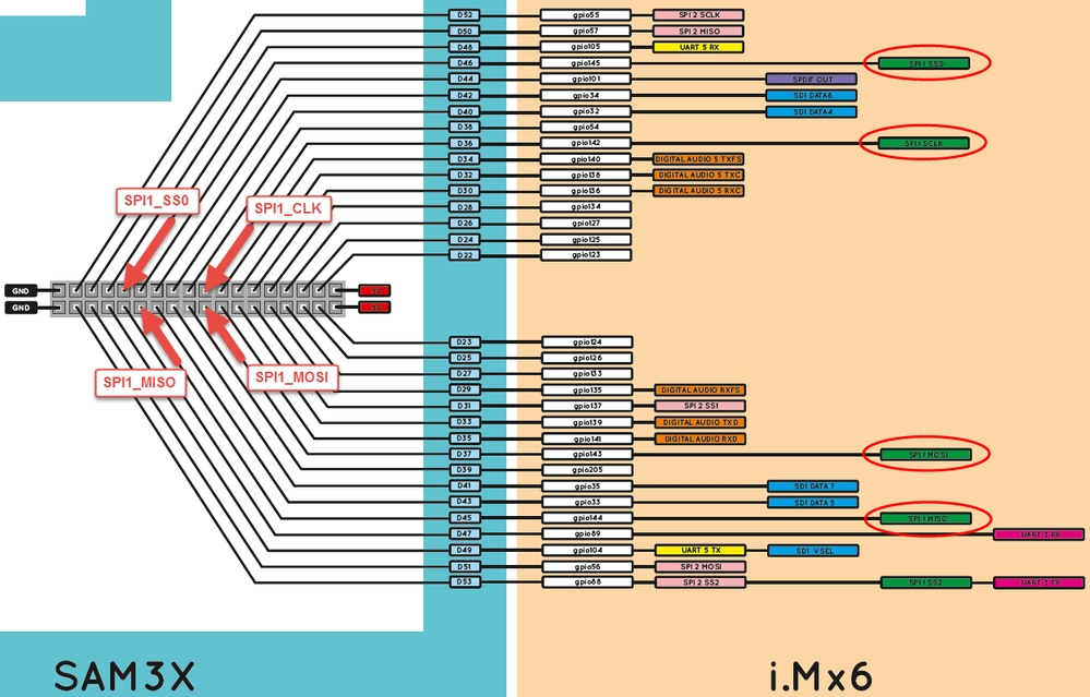

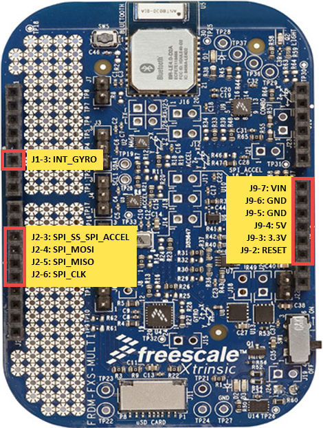

Hardware Connections
 The SPI signals from FRDM-FXS-MULTI are routed to SPI1 module of UDOO Quad. FXLS8471Q provides an INT pin which is indicated on image below, however on this implementation polling method is used. Please note that Chip Select is not controlled automatically by SPI module, therefore this pin is configured as GPIO. Besides these signals, reset and power source pins were also connected.

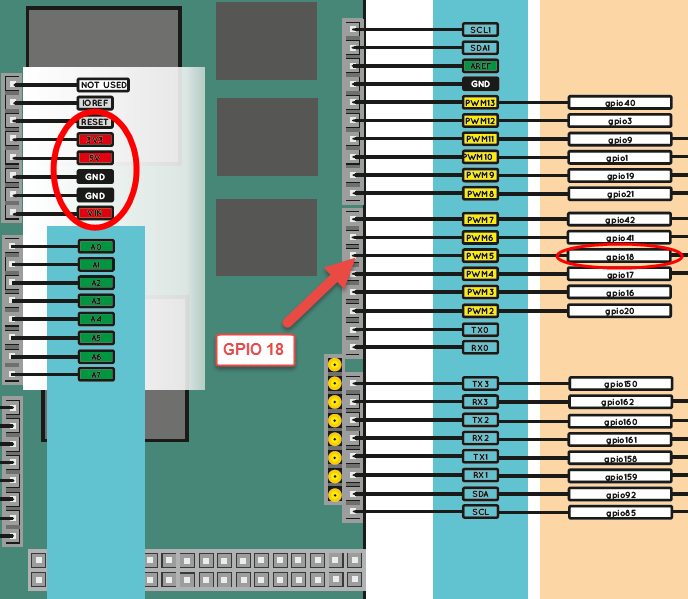

The following figure shows the pins used in FRDM-FXS-MULTI which are connected with UDOO Quad board.
The pins used on the UDOO Quad side are shown in the images below. You can find UDOO Quad pinout diagram here Index of /download/files/pinout.

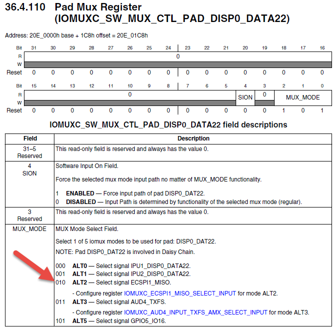

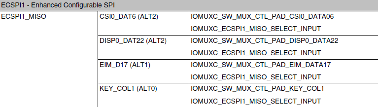

However, as you may know each pin on i.MX devices has up to 8 potential functions, and on the other side, one function can be available in different pins.
For example, ECSPI1_MISO can be mapped to 4 different pins
and each pin can have different functions. From all the available functions in a pin one is chosen to be the pad (pin) name. In the image below DISP0_DATA22 was chosen to be the pad name.
Now, back to pinctrl_ecspi1 node, the macros used here are defined in imx6q-pinfuc.h, as you can see DISP0_DAT20 - DISP0_DAT23 are the pads used with the ECSPI signals.
It is necessary to check it that there are no other configurations for DISP0_DAT20 - DISP0_DAT23 and if they are it is necessary to comment out them or delete them. In this case there were other configurations for these pins in imx6qdl-udoo-externalpins.dtsi and they were commented out.

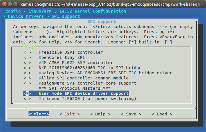

In order to enable the kernel SPI driver it is necessary to set it in the menuconfig and rebuild zImage.
Go to kernel directory within the Yocto build directory that we created.
$ cd <build_directory>/tmp/work-shared/imx6qsabresd/kernel-source$
Launch menuconfig for imx
$ source /opt/fsl-imx-x11/<kernel version>/environment-setup-armv7a-vfp-neon-poky-linux-gnueabi
$ make imx_v7_defconfig
$ make menuconfig
Enable SPI Driver by going to Device Drivers --> SPI Support and seting '*' to SPI device Driver, save changes and then exit.
And build zImage
$ make zImage
The generated file is located in <build_directory>/tmp/work-shared/imx6qsabresd/kernel-source/arch/arm/boot$ and it must be copied to the FAT partition of the SD card.

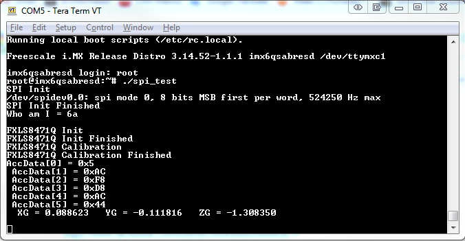

Main
The following code shows function main where the SPI driver is initialized driver using "/dev/spidev0.0" which is listed under /dev (in the target root file system) after SPIdev driver is enabled in menuconfig and kernel is rebuilt as indicated in previous section. Then it reads who am i register just for sanity check purpose and initializes and calibrates the sensor and enters in an endless loop where it reads the sensor whenever there is new data ready. Raw data is returned in 6 bytes, so it is managed to get X, Y and Z values and finally these values are converted to G's values and it waits until a key is pressed to continue to read the following value.
/****************************************************************************** * Main ******************************************************************************/
int main(){
     //enableGPIO(); //In case of using interrupt instead of polling
     file = spi_init("/dev/spidev0.0"); //dev
     who();
     FXLS8471Q_Init();
     FXLS8471Q_Calibration();
     while(1)
         checkData();
         if (DataReady) // Is a new set of data ready?
             buffer = (unsigned char *)spi_read(OUT_X_MSB_REG, 6, file); // Read data output registers 0x01-0x06
             printf("AccData[0] = 0x%X \n AccData[1] = 0x%X \n AccData[2] = 0x%X \n AccData[3] = 0x%X \n AccData[4] = 0x%X \n AccData[5] = 0x%X \n", AccData[0], AccData[1], AccData[2], AccData[3], AccData[4], AccData[5]);
             Xout_14_bit = ((short) (AccData[0] << 8 | AccData[1])) >> 2; // Compute 14-bit X-axis output value
             Yout_14_bit = ((short) (AccData[2] << 8 | AccData[3])) >> 2; // Compute 14-bit Y-axis output value
             Zout_14_bit = ((short) (AccData[4] << 8 | AccData[5])) >> 2; // Compute 14-bit Z-axis output value
             Xout_g = ((float) Xout_14_bit) / SENSITIVITY_2G; // Compute X-axis output value in g's
             Yout_g = ((float) Yout_14_bit) / SENSITIVITY_2G; // Compute Y-axis output value in g's
             Zout_g = ((float) Zout_14_bit) / SENSITIVITY_2G; // Compute Z-axis output value in g's
             //printf(" X = %d Y = %d Z = %d \n\n", AccData[0], AccData[2], AccData[4]);
             //printf("Xval = %d Yval = %d Zval = %d \n", Xout_14_bit, Yout_14_bit, Zout_14_bit);
             printf(" XG = %f YG = %f ZG = %f \n\n", Xout_g, Yout_g, Zout_g);
             getchar();
     close(file);

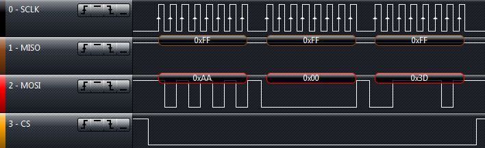

Write
The SPI communication is started with the  falling edge on chip select pin. A write operation is initiated by transmitting a 1 for the R/W bit. Then the 8-bit register address, ADDR[7:0] is encoded in the first and second serialized bytes. Data to be written starts in the third serialized byte. The order of the bits is as follows:
Byte 0: R/W, ADDR[6], ADDR[5], ADDR[4], ADDR[3], ADDR[2], ADDR[1], ADDR[0]
Byte 1: ADDR[7], X, X, X, X, X, X, X
Byte 2: DATA[7], DATA[6], DATA[5], DATA[4], DATA[3], DATA[2], DATA[1], DATA[0]
The SPI communication is finished with the  falling edge on chip select pin.
A you can see below array buf keeps the destination address and the data to be transferred, then xfer structure is configured to point to buf as the transfer buffer and the length of the data es set to 2 + data size (the first 2 bytes are for the destination address which is splitted in 2 bytes). Finally the transfer is started by the ioctl command.
/******************** Write a byte to the FXLS8471Q ***************************
* Byte 0: 1,ADDR[6],ADDR[5],ADDR[4],ADDR[3],ADDR[2],ADDR[1],ADDR[0]
* Byte 1: ADDR[7],0,0,0,0,0,0,0
* Byte 2: DATA[7],DATA[6],DATA[5],DATA[4],DATA[3],DATA[2],DATA[1],DATA[0]
void spi_write(int registerAddress, int nbytes, char data, int file)
 unsigned char buf[32];
 int status;
 memset(buf, 0, sizeof buf);
 buf[0] = 0x80 | registerAddress;
 buf[1] = 0x80 & registerAddress;
 buf[2] = data;
 xfer[0].tx_buf = (unsigned long)buf;
 xfer[0].len = nbytes + 2; /* Length of command to write*/
 status = ioctl(file, SPI_IOC_MESSAGE(1), xfer);
 if (status < 0)
 perror("SPI_IOC_MESSAGE");
 return;
 com_serial=1;
 failcount=0;
Below is the write operation which writes the value 0x3D to the CTRL_REG1 (0x2A).

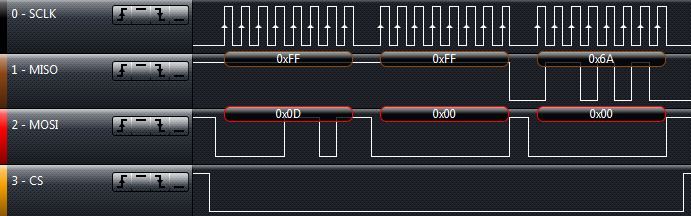

Read
Similarly a read operation is initiated by transmitting a 0 for the R/W bit. Then the 8-bit register address, ADDR[7:0] is encoded in the first and second serialized bytes. The data is read from the MISO pin (MSB first).
In this case the array buf keeps the address that is going to be read and the third byte is just a dummy byte to be transferred. Structure xfer keeps transfer buffer pointer which in this case is buf and receive buffer which is AccData, the lenght of the command to write and the length of data to read is also specified and finally the read command is executed with ioctl call.
/********************** Read a byte from the FXLS8471Q ***********************
* Byte 0: 0,ADDR[6],ADDR[5],ADDR[4],ADDR[3],ADDR[2],ADDR[1],ADDR[0]
* Byte 2: 0,0,0,0,0,0,0,0
char * spi_read(int registerAddress, int nbytes, int file)
 int status;
 memset(AccData, 0, sizeof AccData);
 buf[0] = 0x7F & registerAddress;
 buf[2] = 0x00;
 xfer[0].len = 2; /* Length of command to write*/
 xfer[1].rx_buf = (unsigned long) AccData;
 xfer[1].len = nbytes; /* Length of Data to read */
 xfer[1].speed_hz = 524250;
 status = ioctl(file, SPI_IOC_MESSAGE(2), xfer);
 if (status < 0)
 return 0;
 com_serial=1;
 failcount=0;
 return AccData;
The screenshot below shows the read operation which reads the correct value 0x6A from the WHO_AM_I register (0x0D).
