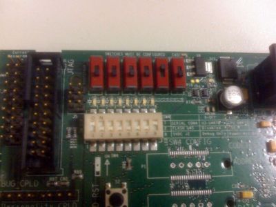

2 - Some hardware configurations (switches) must be done to flash the board.
Set red and cream switches as below:
Switch SW5 -> 00000
Switch SW4 -> 10000001

PS: On SW5 and SW4, "1" means the keys selected towards the edge of the board.

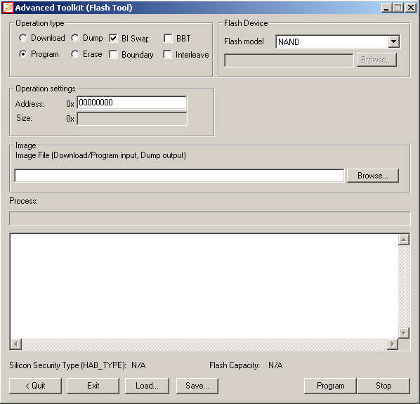

3 - Run ATK by clicking Start -> Programs -> AdvancedToolKit -> AdvancedToolKit
   Set the options:
   Device memory -> DDR; Custom Initial File -> (keep it unmarked)
   Communication Channel -> Serial Port (Usually COM1)
4 - Click on Flash Tools to erase, program or dump the the flash memory and click GO.

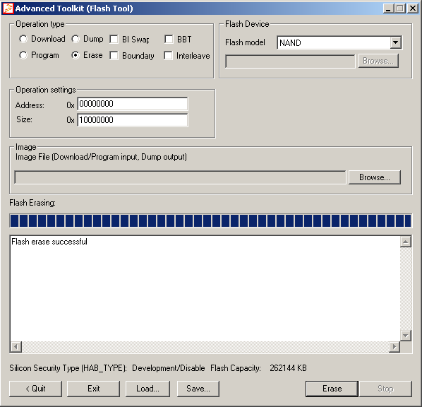

Flash Erasing
1 - To erase Flash memory, select the parameters as shown in the figure below:
2 - Turn on the board and press Erase.
3 - ATK shows this message when flash is erased

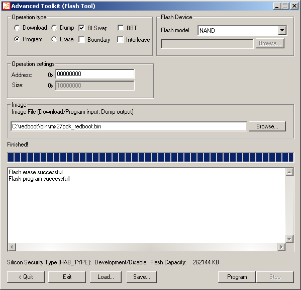

The next step is to program the bootloader image into the board's Flash following the steps below.
1 - Select the parameters as shown in the figure below and press Program.
The bootloader binary image file can be found into your Board Support Package
Set Program, NAND, Address: 0x00000000
2 - Add it on Image File field and press Program.

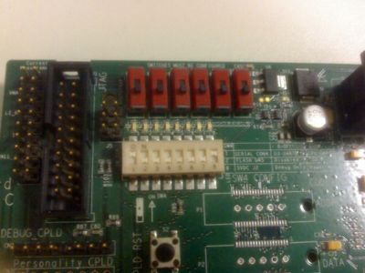

3 - Close ATK, turn off the board and set switch back as shown in the picture below.
