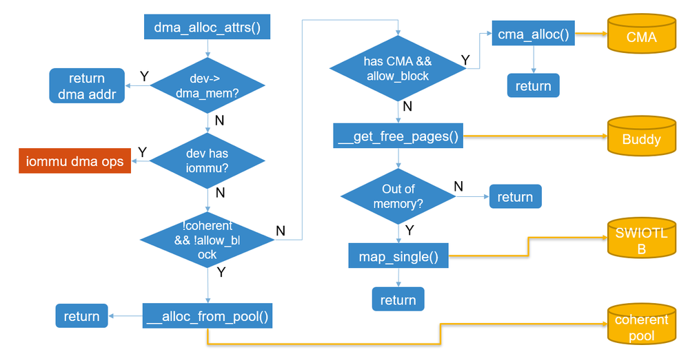

In arm64 kernel, the DMA allocation API would allocate memory in a various way which depends on the device configurations (in dts or gfp flags). The below table shows how the DMA allocation API (w/o IOMMU enabled device) works to find a proper way for pages (by order, coherent pool -> CMA -> Buddy -> SWIOTLB):
Allocator (by order) Configurations (w/o IOMMU) Comments Mapping
Coherent Pool
  • device dma is not coherent
  • GFP flag is not allow blocking
By __alloc_from_pool() Already mapped on boot when coherent pool init in VMALLOC
CMA
  • device CMA or system CMA is present
  • GFP flag is allow blocking: __GFP_DIRECT_RECLAIM set
By cma_alloc() map_vm_area, mapped in VMALLOC
Buddy
  • No CMA (device or system) or GFP not allow blocking
By __get_free_pages(), which can only allocate from the DMA/normal zone (lowmem), 32bits address spaces Already mapped in the lowmem area by kernel on boot
SWIOTLB
  • No contiguous pages from buddy or
  • return buffer area region > device dma_mask
By map_single() Already mapped on boot when SWIOTLB init
Also a diagram shows how it works (DMA allocation path):
By default, kernel uses CMA as a backend of DMA buffers allocation for most of the cases. That's why i.MX BSP use CMA in the default release for GPU/VPU/CSI/ISI or other buffers for DMA transfers.

To get rid of CMA, the basic idea is to cut off the CMA way in the DMA allocation, turn to coherent pool (atomic pool). Please not that coherent pool can only be used by DMA allocation API, it's not shared to system buddy.
1. Enable coherent pool
Add “coherent_pool=<size>” in command line, Coherent pool is actually allocate from system default CMA, so CMA size > coherent_pool.
There's no reference for this size, as it's various from system to system and use cases to use cases:
  • The biggest consumer of DMA is GPU, it's usage can be monitored by gmem_info tool. Monitor the gmem_info under the typical use cases, and settle down the GPU required memory.
  • Checking for 2nd consumer of DMA: ISI/Camera, depends on the V4l2 reqbuf size and numbers
  • Checking VPU, depends on the multimedia frameworks
  • Plus alsa snd, USB, fec usage
The size must be verified by test to make sure system stable.
