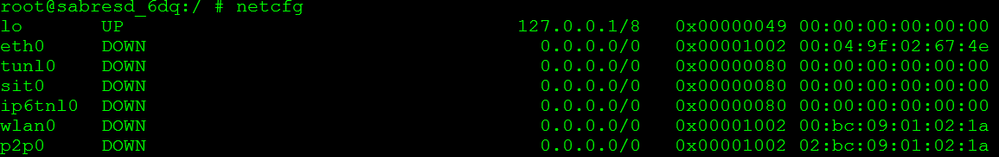

  • Firstly, disable wifi in Setting UI. then you can check netcfg result, you will see wlan0 and p2p0 are still there, only down state:

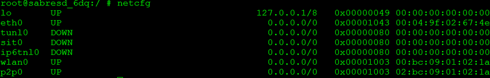

  • Go "advanced" menu in wifi setting,Turning on the checkbox of "Scanning always available". Check netcfg result again, Oh Oh, wlan0 and p2p0 are up:

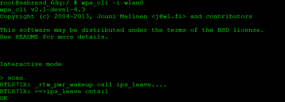

  • Manually "scan" through "wpa_cli" tool, you will see it works:
