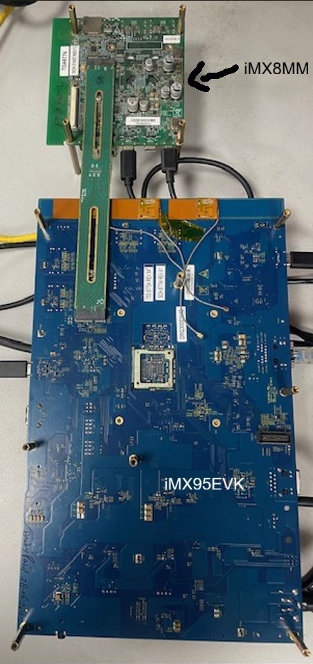

In this blog, we are going to discuss how we can configure iMX95EVK as PCIe Endpoint and test it using a RC which will be iMX8MM.
Hardware Components
iMX95EVK
iMX8MM
PCIe M.2 Key E Bridge
Ethernet connectivity

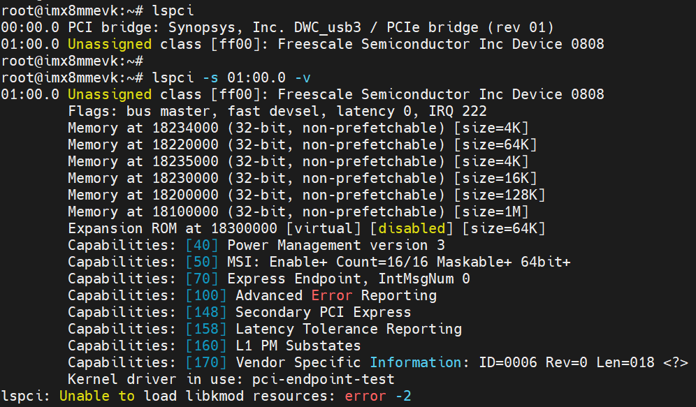

when the kernel boots up with this dtb, you will see the following pcie dmesg logs on the console through which you can verify if the changes have worked:-
root@imx95evk:~# dmesg | grep pcie-ep
[    3.142123] imx6q-pcie 4c300000.pcie-ep: iATU: unroll T, 8 ob, 8 ib, align 4K, limit 1024G
[    3.151767] imx6q-pcie 4c300000.pcie-ep: eDMA: unroll T, 4 wr, 4 rd
root@imx95evk:~#
0x4c300000 is the address of pcie0 controller
Step-6 Execute this script on iMX95EVK - 'conf_pcie0_ep'
Step-7 Boot iMX8MM board with this dtb - imx8mm-evk.dtb
Step-8 Executing 'lspci' on the iMX8MM, you will see the following output:-
That's the iMX95EVK Endpoint that you see on the lspci output of iMX8MM RC.

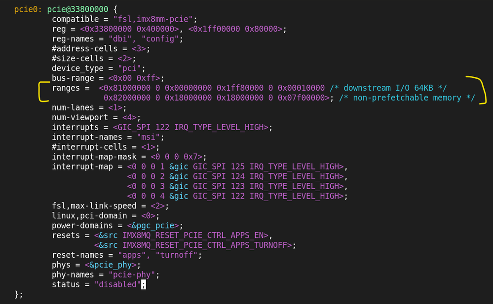

The address space translation window is configured with the help of the info mentioned in
arch/arm64/boot/dts/freescale/imx8mm.dtsi
If the readers want to make sense out of the translation window info mentioned in form of 'ranges' property of PCIe node, they can go through this article in which there is a detailed explanation of what is going behind the scenes - Demystifying the PCIe and CPU address space translation in Linux - NXP Community
