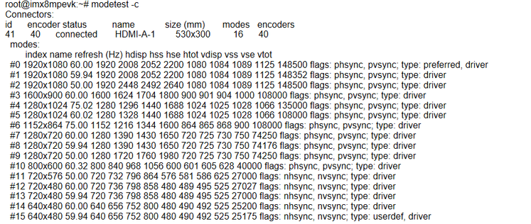

After add the result to the struct, you need to re-compile the kernel and boot your board, then run the "modetest -c" command Check whether the changes are effective
when you run the modetest -c command, the following code show as below, You can see all the resolutions currently supported by your monitor.
