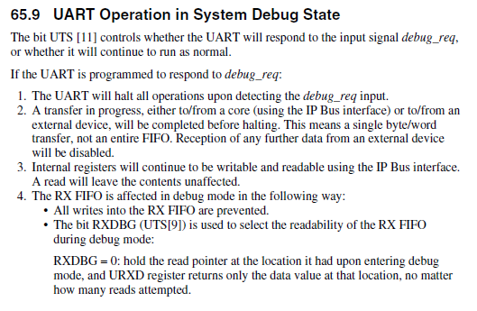

There is one small difference with general debug case to M4 in 6sx, which when you attach M4 and break M4, it may impact the peripheral that A9 is using. You may have found when you break M4, A9 uart console also was frozen at the same time.
  • This is caused by that when M4 enter debug mode, the debug_req will also assert in the peripherals which you are using on the A9 system.
  • So,need configure the peripherals to keep running when the debug_req is assert when do the M4/A9 debug separately.
  • Need configure the DBGEN (*) register in the related peripherals to allow the eripherals not going into debug mode and keep running even if debug_req is HIGH.
  • The peripherals we need take care are: CAN, UART, EPIT,GPT, ENET, PWM.
  • Note: For the CAN, the register bit is called FRZ

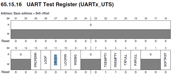

Here is the details of uart dbgen in the RM:
So if we want debug M4 separately,we should disable this bit, as A9 was using this peripheral.

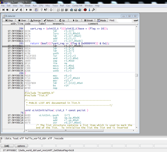

  • Attach M4 using the m4.cmm file(attached):

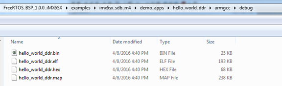

Note:  You can find the elf file at the same folder of binary:
So now you can debug your code step by step.If you go back to A9 side uart console, you would find the console have been frozen.
