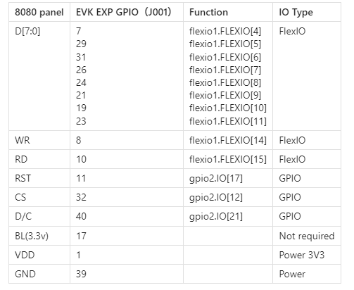

The purpose of this document is to provide guidance for FlexIO 8080 display capability. Generally, the 8080 bus interface consists of one chip-select line (CS), one writing-latch line (WR), one reading-latch line (RD), one data/command-select line (RS, also called D/C), and 8 or 16 bidirectional data lines (Data Bus).

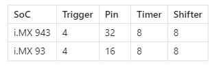

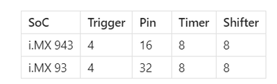

Since The FlexIO instance of i.MX 943 support only 16 pins, the demo can only support 8 bit 8080 mode(two pin should be used as WR and RD signal.
Below are pins used in the 8 bit 8080 display.

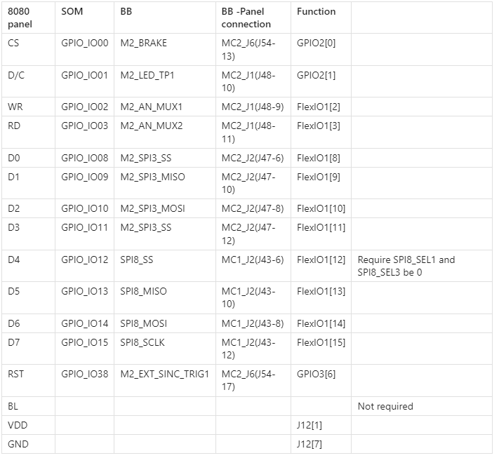

Connection and Software
i.MX 943
Need pull down SPI8_SEL1 and SPI8_SEL3 of PCA6416 in SW to select Arduino for 8080 pins D[7:4].
Here is the patch for system manager. For quick verification, use flash_m70 when building bootloader.

+# 8080
+PIN_GPIO_IO00 OWNER
+PIN_GPIO_IO01 OWNER
+PIN_GPIO_IO02 OWNER
+PIN_GPIO_IO03 OWNER
+PIN_GPIO_IO08 OWNER
+PIN_GPIO_IO09 OWNER
+PIN_GPIO_IO10 OWNER
+PIN_GPIO_IO11 OWNER
+PIN_GPIO_IO12 OWNER
+PIN_GPIO_IO13 OWNER
+PIN_GPIO_IO14 OWNER
+PIN_GPIO_IO15 OWNER
+PIN_GPIO_IO38 OWNER
+# I2C6
+PIN_GPIO_IO28 OWNER
Attached imx943_flexio_8080_8bit.zip is patch for m70 demo based on SDK_25_06_00_MCIMX943-EVK.
