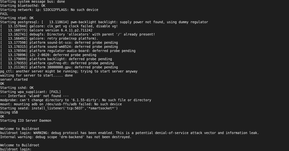

 To enable qemu support, fetch the qemu repo's master branch and apply the patches attached with this blog. Build the qemu after the patches are applied. Steps to build are mentioned in the repo's readme itself -
https://github.com/qemu/QEMU
There are 2 ways you can test these changes:-
1. Using the functional testing python script that comes as a part of these patches.
Execute the following to trigger a test:-
python3 tests/functional/aarch64/test_imx8mm_evk.py
This functional test boots a linux kernel and checks the console. It will return Ok if it succeeds.
  1. Using the kernel 'Image' and imx8mm dtb from your bsp and rootfs img file which can be downloaded from here - Buildroot 2024.02 Release for i.MX Platforms | Ezurio
    After you have the 'Image', 'imx8mm-evk.dtb' and downloaded rootfs '20240522-br2024.02-nitrogen8mm_qt5_gst1.img', execute this command in the build folder:-
    ./qemu-bundle/usr/local/bin/qemu-system-aarch64 -M imx8mm-evk -smp 4 -m 3G -display none -serial null -serial stdio -kernel ~/qemu-emulation/iMX8MM/Image -dtb ~/qemu-emulation/iMX8MM/imx8mm-evk.dtb -append "root=/dev/mmcblk2p1" -drive file=~/qemu-emulation/iMX8MM/20240522-br2024.02-nitrogen8mm_qt5_gst1.img,if=sd,bus=2,format=raw,id=mmcblk2
