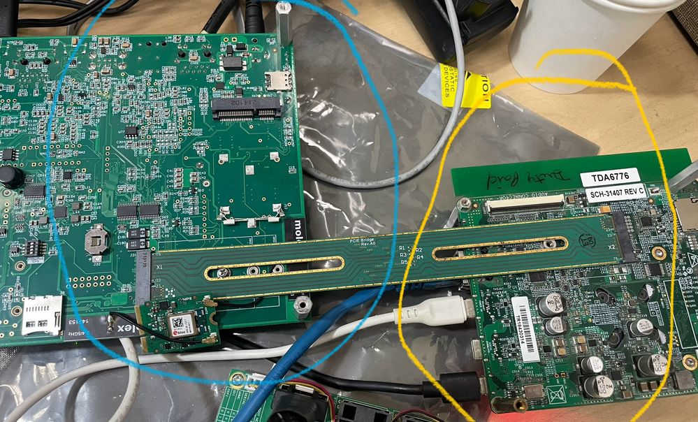

Connections:-
iMX95 Torradex RC will be connected to iMX8MM EVK via M.2 PCIe bridge
iMX95 Torradex board [RC] connected to iMX8MM[EP] via PCIe bridge on M.2iMX95 Torradex board [RC] connected to iMX8MM[EP] via PCIe bridge on M.2

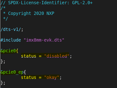

         b. Boot Linux with this dtb  -> imx8mm-evk-pcie-ep.dtb
         location of the dts in the linux bsp -
         linux-imx/arch/arm64/boot/dts/freescale/imx8mm-evk-pcie-ep.dts
         If you closely observe this dts:-
             It is just disabling the default pcie0 node and enabling the pcie0_ep node. This is because the PCIe drivers need some type of indication from the dtb at boot up so that end-point controller can be created via EPC driver in the Linux kernel.
