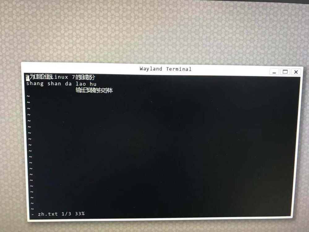

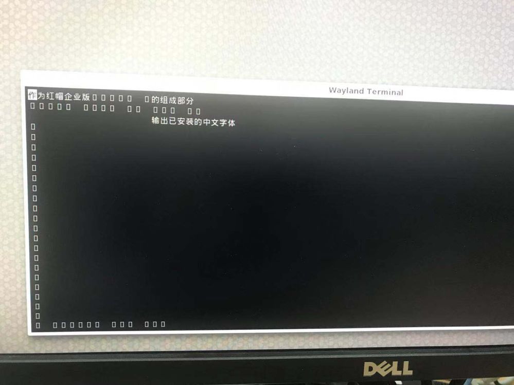

The secend step is to change default fonts. In weston-terminal.c we can see:
          3119   weston_config_section_get_string(s, "font", &option_font, "mono");
          3120   weston_config_section_get_int(s, "font-size", &option_font_size, 14);
 weston-terminal default use mono font.Just to modify /etc/fonts/fonts.conf
          <edit name="family" mode="assign" binding="same">
                      <string>monospace</string>
to   <string>Microsoft YaHei Mono</string> or <string>Droid Sans Fallback</string> could display Chinese character
But it have some problem such like as :
the left use Microsoft YaHei Mono font the Chinese character is overlapping ,the right use Droid Sans Fallback font is en-font could not display.
